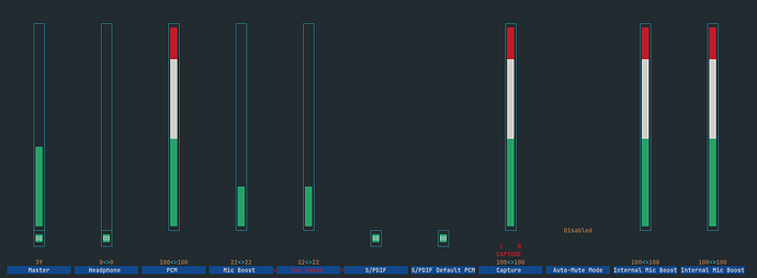

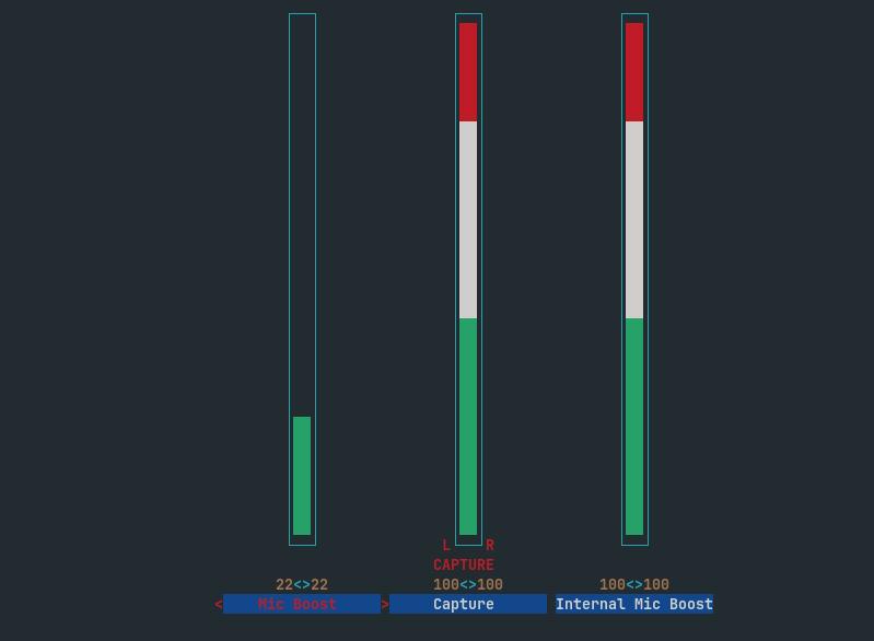

Hit F5 to show all sound channels, both inputs and outputs.
Try unmuting any speaker and headphone channels marked "MM" by using arrow keys to the channel, then type "M" to unmute the channel. Increase volume using up-arrow.
Also play with [Auto-Mute] and [Loopback-mode] channel settings and see if any effect.

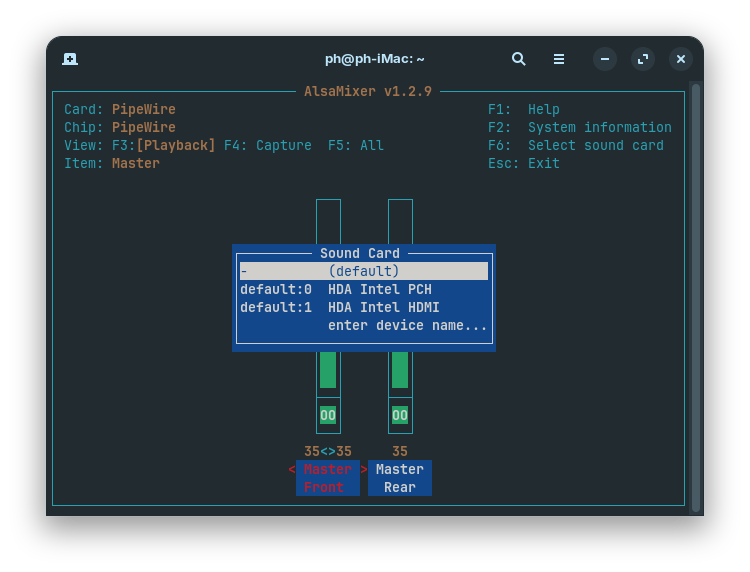

Hi,
Screenshot after selecting F6

Hi

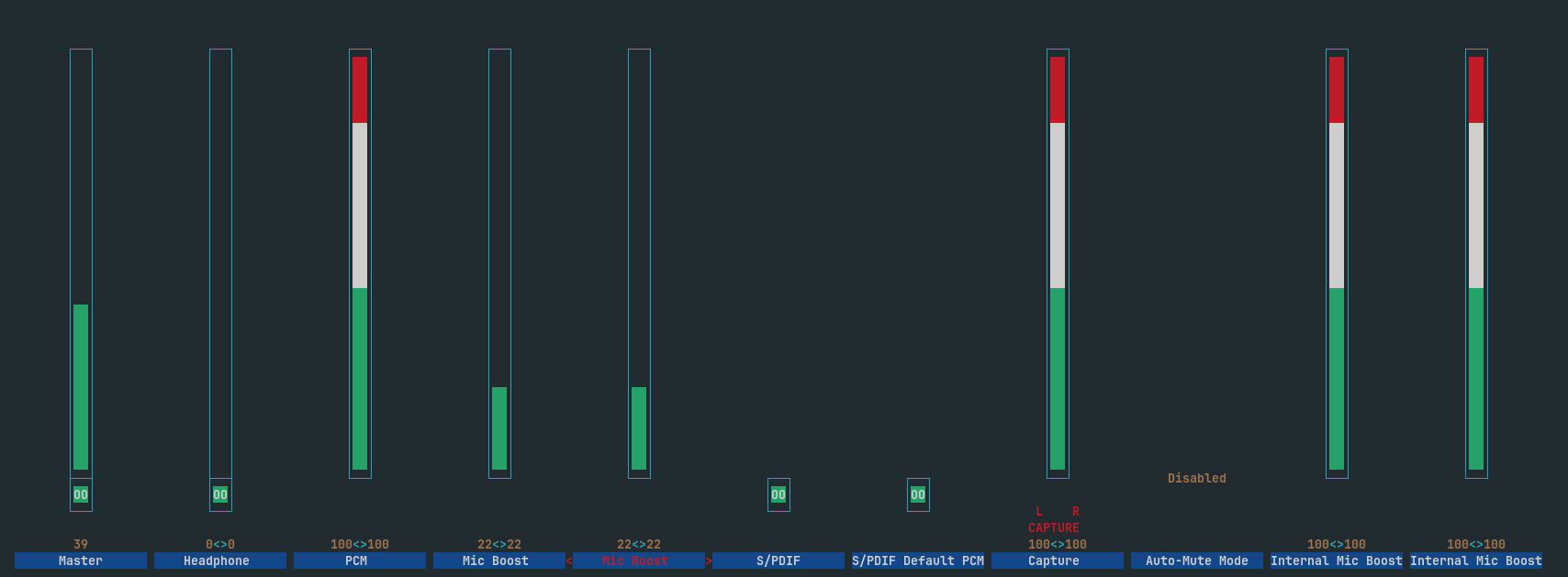

I have followed the instructions for alsamixer and pulse audio> have attached some screenshots. I can only get sound if I change the configuration from Analogue Stereo output to either Analogue Surround 2.1 output or Analogue Surround 4.0 output.

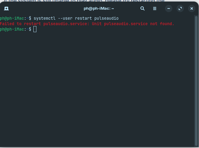

If I try to restart the audio server I receive the following message
Any help would be much appreciated.

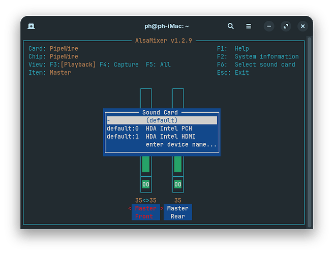

I am puzzled why alsamixer is showing "PipeWire" for both sound "Card" and "Chip", instead of the actual hardware from your first screenshot.
Hi @zabadabadoo,
Being a complete novice to Zorin OS, I cannot answer that. If I have understood this correctly, alsamixer is suggesting my iMac has two sound chips, I am sure it only has one.

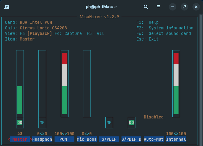

I wonder if this item could help: No sound from built-in speakers on MacBook 9,1 - Support and Help - Ubuntu Community Hub
Note it says. ref alsamixer "If it shows PulseAudio press F6, pick HDA Intel PCH"
If you choose "HDA Intel PCH" does it then show sound chip = "cirrus logic cs2048" instead of Pipewire?
Hi @zabadabadoo
It does, screenshot below:

Zorin OS 18 uses pipewire and Zorin 17 uses PulseAudio which would explain why I cannot restart the audio server using the instructions in Zorin's help section. It has probably not been updated to date.

alsamixer now shows the sound card and sound chip as I would expect to see.
If in doubt, unmute everything marked [MM] in alsamixer, e.g. headphone shows [MM].
Note, if you find an alsamixer setting that works for you, save it using:
sudo alsactl store
