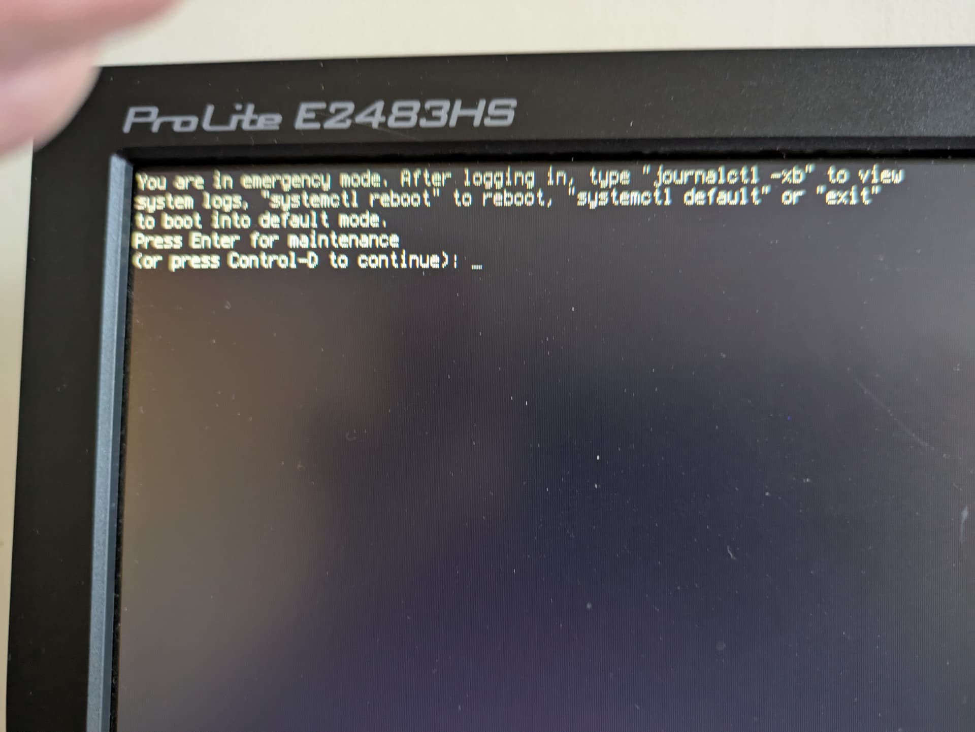

Got up today and back to the same error. Once I get stuff reinstalled, I'll post the error from a photo on my phone. Hah! Found a use for Zorin Connect

You need to boot in recovery mode (Advanced boot option), drop to a root terminal and run fsck.
sudo fsck /dev/sdX
change X to the letter of your drive/partition that is causing you problems. If you get complaints about partition being mounted you could try from live distro. I once lost /home completely (not showing in GParted) and had to use a live version of Kali to run e2fsck.

Do I assume it's one of sda1-3 on my SSD boot drive? I've not managed to do whatever it says in the small print on the error screen - read log etc
When you get to Advanced menu, choose recovery, a menu appears. The last item should be drop to a terminal. In respect of the sda command I think you need /dev/nvmexxxx

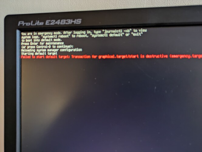

I also tried to do what you said, and get the first screen - no idea what they mean. I tried the fdsk option and the grub thing, with no difference in the outcome.
The second screen shows the disk usage

OK, If you get to that menu again, use the cursor down arrow to get to 'Drop to root shell prompt'. Press enter then:
sudo fsck /dev/sda3
Looking at your drive it looks like you have everything on one partition in respect of the OS. You may come across a warning that you can't run fsck because /dev/sda3 is mounted. In which case you would need to run Zorin in live mode and then open a terminal in your live session of Zorin and try running fsck command from that. All your tmpfs files are using RAM not your hard drive.
