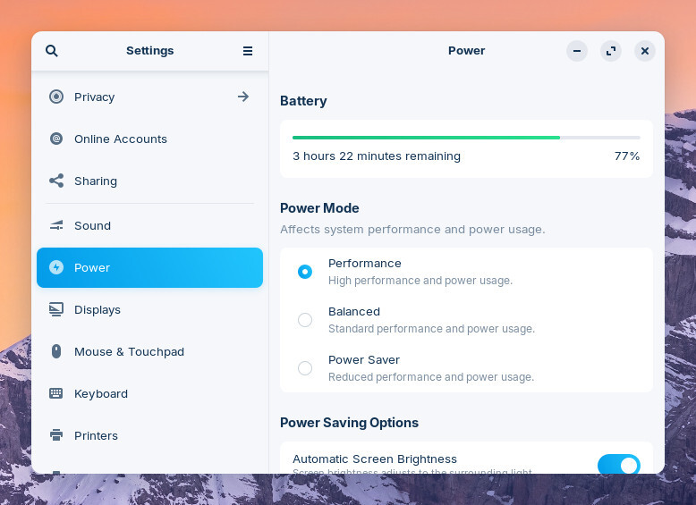

If your a gamer or do production workloads, make sure you set your power settings to Performance, and make sure you've selected your Nvidia GPU driver, if you have Nvidia. If you have AMD, your driver is already in the kernel.
