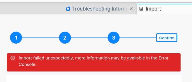

Sadly an import failed with 'Import failed unexpectedly'. I'll uninstall the flatpak and carry out all instruction again from fresh.
This may be an error with the application itself, not with how it's installed. As I don't use Thunderbird myself I'm not too familiar with what it is that it's supposed to be looking for when importing profiles. If you're importing from another file that exists in your file system, make sure to place that file inside the Downloads folder (this has to do with Flatpak packages, I'll explain later).
