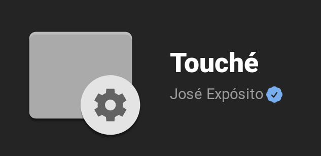

Hmm ... You could try a Program called Touché which is for Touchpads. You can install it in the Software Store:
