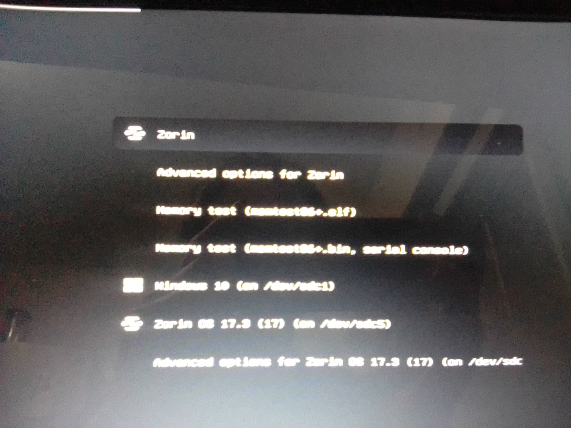

In picture, the order is: Zorin Core, Win 10, Zorin Lite

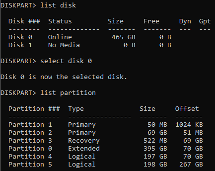

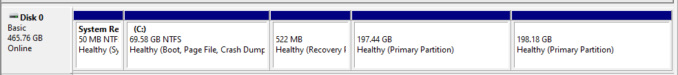

In Windows' Disk Management tool, the last 2 partitions are for the 2 Zorin OS-s; they are wrongly labeled Primary, when in fact they are Logical, and within an Extended partition, as the picture of Diskpart utility shows next.

  1. Re-installed my windows 10 (for a different reason than installing linux). Took advantage of this to make all 3 windows partitions (System Reserved, Windows C:, Recovery) be within the first 70GB of the disk.
  2. Inside Windows 10, with . Disk Manag., I created Extended partition for the rest of disk. I think this was optional: I could have just proceeded with installation of Zorin where I could have chosen Logical partitions

From what I read, the last OS to have been installed (Z. Core in my case) - that creates the Grub entry and sets that last OS to be first & default in the boot menu.
When I decide that I prefer a different OS than the top one, I'll just need to find way to change the order of OS-s in that boot menu.
Does anyone know how to change that order?
And also how to change the time to wait till the default OS in the list is started?
Or a just good reference that explains it. Thanks.
Can you translate it? The instruction is in German.
You can edit the file ect/default/grub
Change grub default and grub timeout.
Count the number of positions of the operating system in grub menu that should start automatically (start counting with 0) and enter this value in grub default. The default waiting time is 10 seconds (grub timeout=10) and can be changed as required. Don't make it too short so that you can enter grub when there are (boot) problems or you want to boot another kernel.
