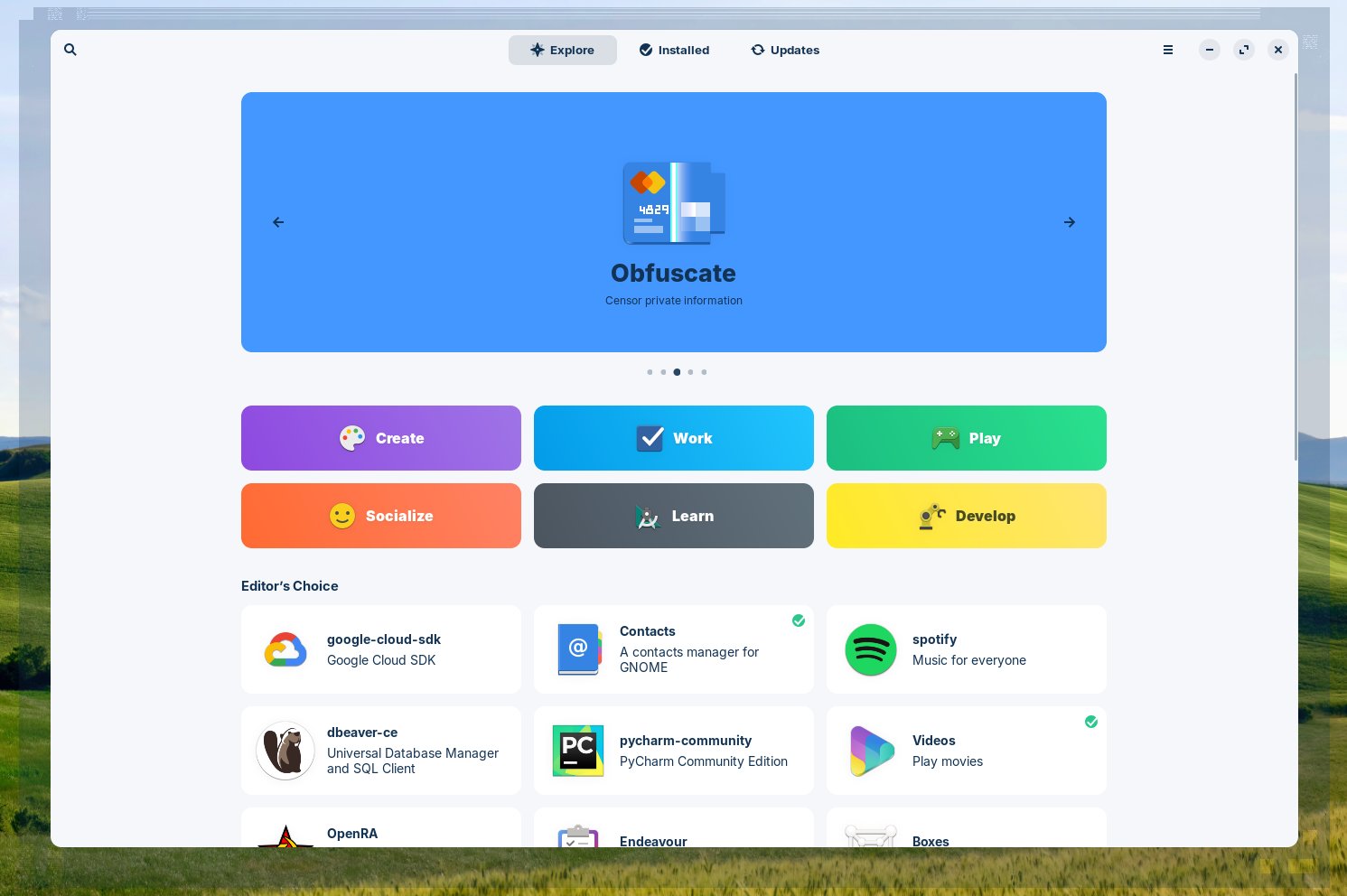

First bug:
See attached picture. It's self-explanatory. I am using the included proprietary NVIDIA drivers. When I installed Zorin OS 17 Pro, I chose the option to load the live USB with "modern NVIDIA drivers," and installed Zorin from the live desktop. This strange screen artifact seems to happen only with the software store. Also, when I tested Zorin OS 16.3 Core (live), this did not happen. Maybe this is a bug that Zorin needs to investigate? I use a NVIDIA GeForce 1060 3 GB card.

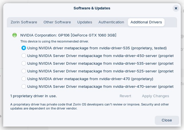

Hi, Aravisian:
Surely. See below, please ...
Re: NVIDIA driver - see below screenshot ...

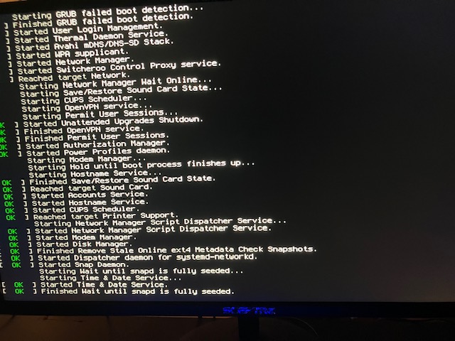

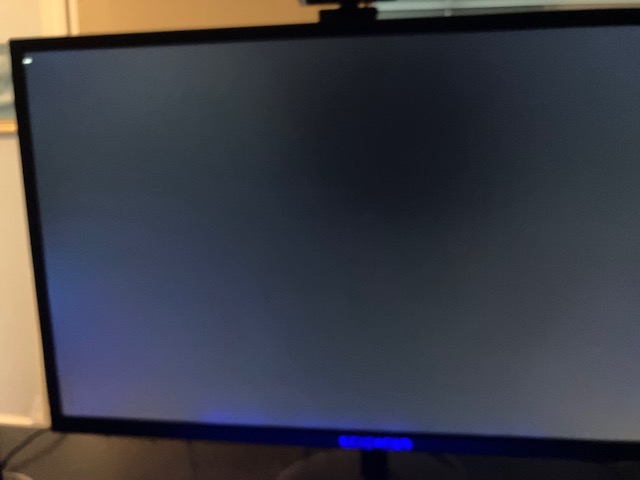

OK. I've got quite an update here. I'm actually using the "Noveau" drivers. What happened was that I tried to switch to another NVIDIA driver using System Settings (to an earlier version). What happened was that my computer wouldn't boot correctly. See pictures below. Not sure what happened.
IMG_0572
IMG_0570
It was not until I got back into my account using recovery mode that I was able to switch over to the "Noveau" driver and resume normal boot function. I tried switching to another NVIDIA driver, and I got the same result as what you see in the pictures above. I went back to the "Noveau" driver, and once again I have normal boot function. Any idea on what's causing this, and how can I fix it? I'm loath at the idea of reinstalling Zorin, even though this is a fresh install with relatively little work gone into customizing it.
Frustrating ...
One more thing - the picture of the blinking cursor is just that - it leads to nothing. I kept waiting and waiting until I gave up and tried to restore access through the recovery menu. Thank goodness I was able to switch the drivers to the Noveau drivers, but now I don't have 3D acceleration for my games, etc. Help. Thanks!

Using (as you already demonstrated via your previous screenshot); Software & Updates > Other Software, you can switch Nvidia drivers.
If this means is not working, something may be interferring.

There is only one Open Source Nvidia driver: Nouveau.
The rest will show as server, proprietary or tested.
This is where things get complex.
  • All of them are proprietary.
  • The Server edition is identical to the rest. the only difference is that the server edition has longer support for security patching.
  • The 470 (proprietary, tested) driver turned out buggier than the 470 (proprietary). The tested notation is supposed to mean that the driver was tested for performance and stability.
With the first point: All are proprietary. This means that they are locked from any code review or modification by either us or the ZorinGroup. It is like a sealed box that we are not permitted to open.
These are created by, supplied by and maintained by Nvidia and if there happen to be bugs; it is due to Nvidia. ...And... Nvidia has a very long reputation of pushing out products with bugginess in their drivers. On all OS's. Sadly, for us, the users, on Windows O.S. or GnuLinux, the best we can do is try changing drivers or kernels.
