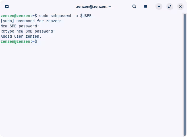

I normally prefer to do things on the command line because while it's less intuitive and you have to look stuff up, you have a much better idea of what's going on. But in this case, it seems like you actually have to use the command line no matter what. Or, at least, I couldn't find a way to do it.
However, it's fairly simple to set up as you only need to ensure there's a user registered within the SMB internal database:
Thank you. That was very helpful. In fact, I am now able to access the one folder...
