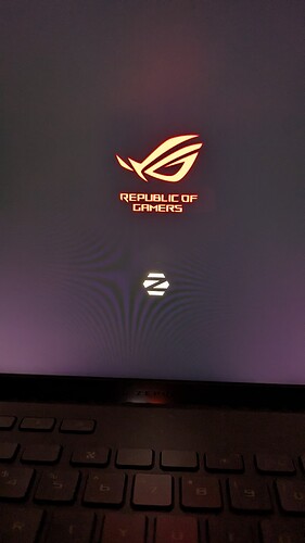

Another small update, 4th installation attempt. Safe graphics again, this time I get the logo but nothing happens. I haven't reboot or anything, it's been like this for a few mins now:
When you boot, do you get a grub menu asking if you want to boot Zorin or Windows?
If not:
try tapping the esc key before you get to that splash screen. Tap that key like you are playing Mortal Kombat.

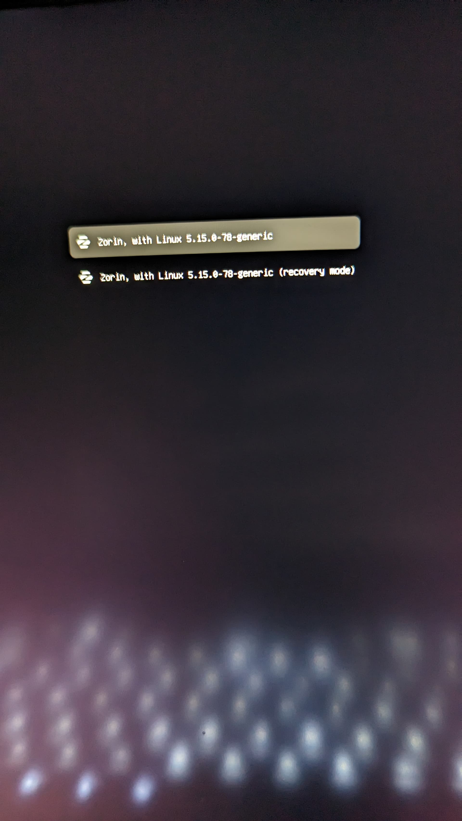

At the grub menu, select Advanced Options for Zorin
Then relay which kernels are listed.
Ah yep I do get the grub menu. The kernel listed is:
Which seems old? Since when I tried Fedora the kernel I updated to was 6.4.7
Great. One kernel. And it is not working.

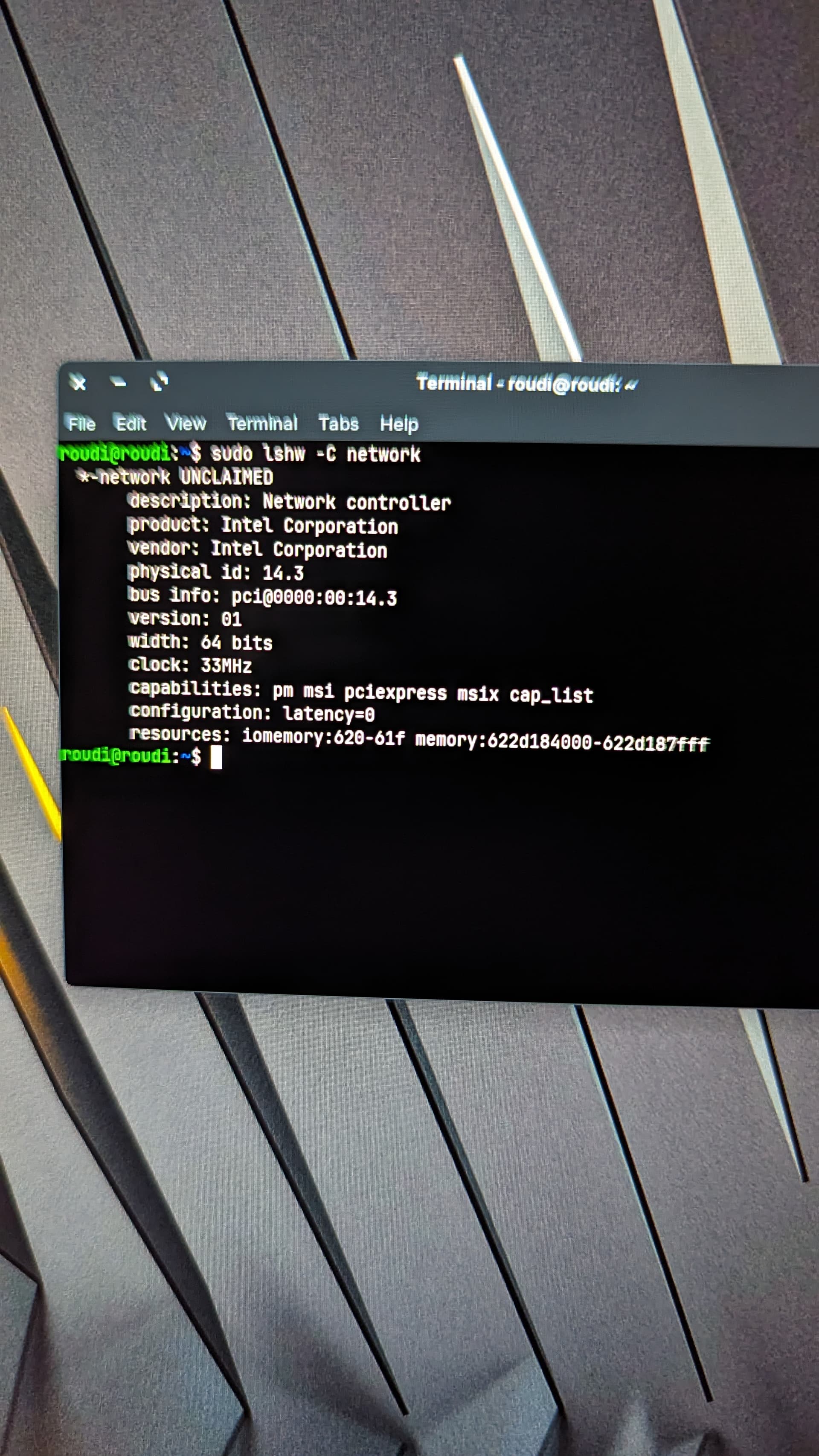

Wifi
In terminal please run
sudo lshw -C network
and relay the output here.
Googling the above seems like the drivers aren't installed. Right?
