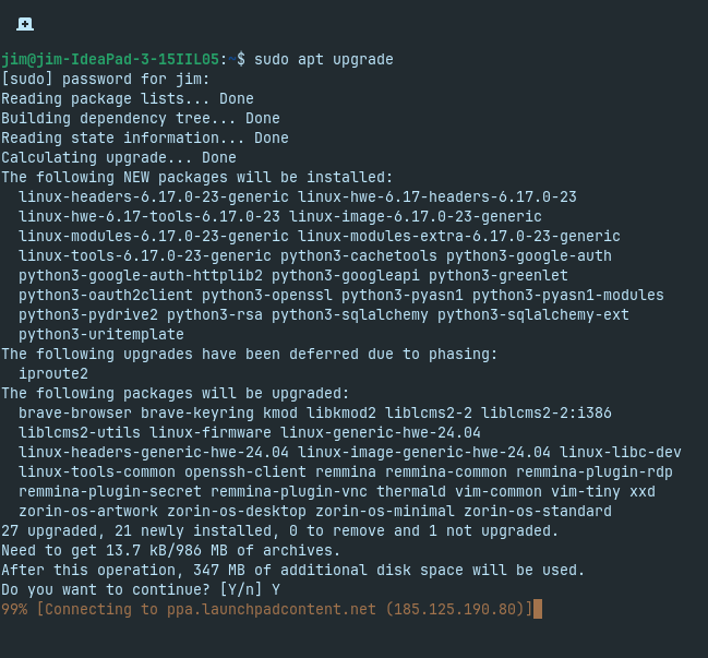

Within the last week or so, my daily updates are failing. I have some experience with Linux so I dropped down to the terminal and it's still failing when I do 'sudo apt upgrade'. At first I thought it was failing on the IPv6 address that it was trying to reach ppa.launchpadconent.net on, and I don't run IPv6 on my internal network (have it disabled on my Ubiquiti router), so I opened the connection properties for the SSID I normally use at home and changed the IPv6 properties from Automatic to disabled.
It's still not working after that, it does seem to try to connect to an IPv4 address now for ppa.launchpadconent.net, but it still won't do the updates. It seems to fail at "waiting for headers" when I watch it in the terminal.

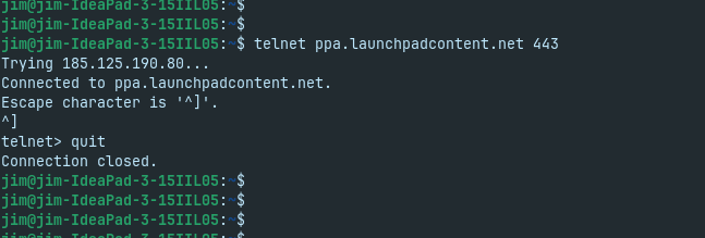

I tried to telnet to ppa.launchpadcontent.net on 443 and it does connect, so I don't think my firewall rules on my Ubiquiti router are blocking the connection, I do have some geoblocking and so forth set up on Ubiquiti.

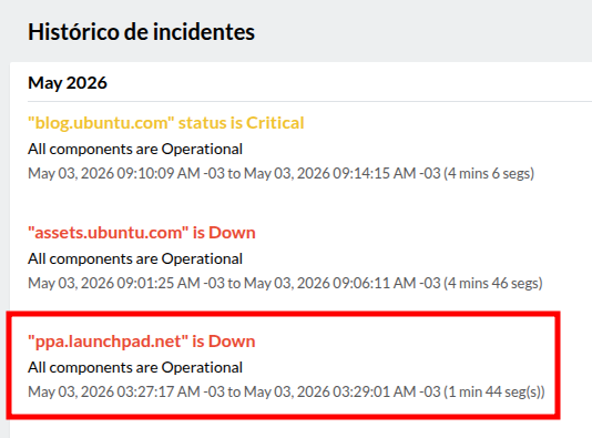

Ubuntu's servers were down, which you might see mentioned in other threads. ppa.launchpadcontent.net is Ubuntu's. As a derivative of Ubuntu, for updates the Zorin brothers don't personally manage and configure come straight from Canonical's servers. It sounds to me like you ran into that, and then your GUI attempt just happened to be on the good side of Canonical getting them back up.
This is because of a Server Issue:

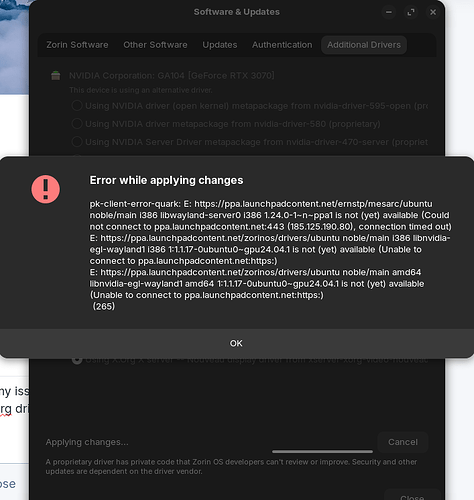

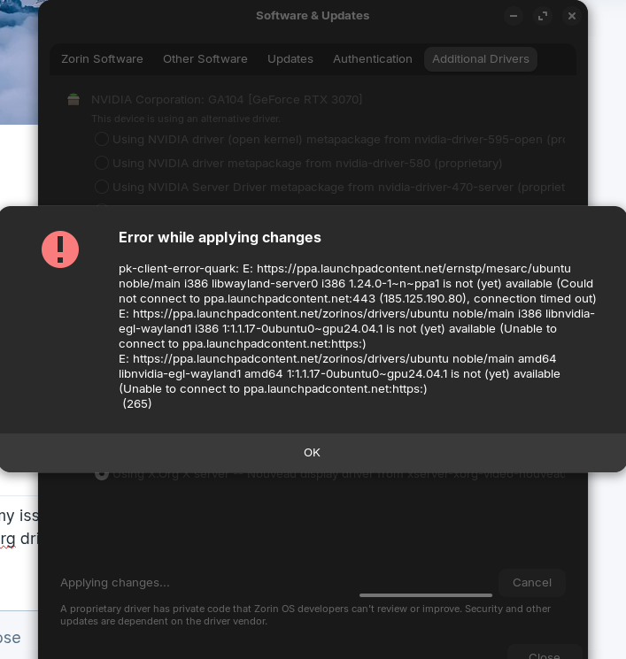

somehow after upgrading firefox, it switched me from x11 to wayland, and now i can't select any driver other than the default, without getting a pk-client-error-quark issue for the launchpadcontent site.
The servers are now operational but suspect it may take a bit of time to settle down. Have you tried visiting mozilla and install a tarball edition?:

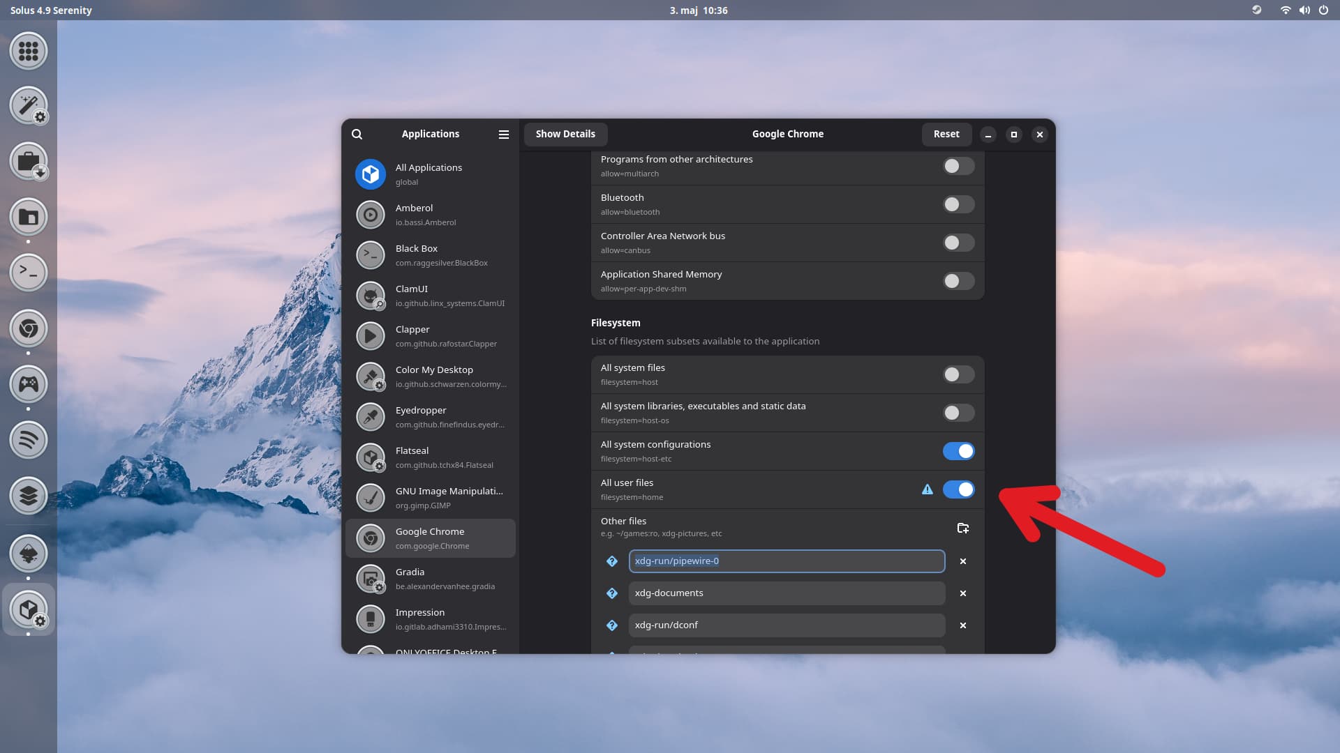

Is it flatpak of Firefox? Then you need to setup the permission with flatseal?
Like this (this is with chrome flatpak);

Canonical and Ubuntu Status

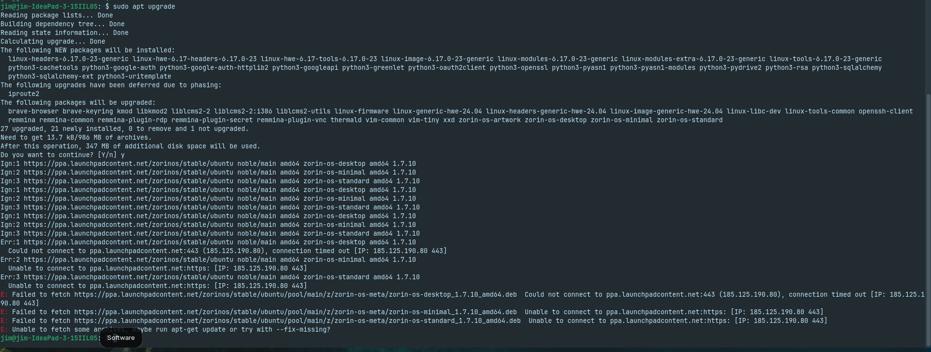

Yeeeeah...i try update but connecting with ppa.launchpadcontent.net and still not working(34 packsges i have to updahe like ssh-client or header fo kernel modules but nothing from ppa.launchpadcontent.net because time to connet was too long)
unfortunately, my issue is in graphics drivers. im defaulting to xorg drivers, which are not ideal for the games im trying to play (causing immense lag). none of the options i'm selecting seem to work either. its so odd that these drivers arent stored locally after downloading and seemingly require a connection to change them.

Only to be clear here: The Drivers that You see in the List of the ''Additional Drivers'' Tab are only the Options that You have. That they are not all downloaded and saved is Intention. You choose one Driver and that will be installed. The others not.
Because of Your current Situation: From the Picture, it looks like the there will be downloaded some Files from PPA's that are located on Launchpad. and because of that, this Process doesn't work unfortunately.
amigo ten un poco de paciencia unos iranies esta atacando la plataforma de linux o a zorin en cuyo caso mantente a la espera y s epaciente no vas a morir por no actualizar tu sistema ya que lo estan atacando con DDos y la proxima antes de crear otro tema mira otros temas actuales y leetelas aveste te enteras de las novedades o fallas o lo que suele pasar lo se que eres nuevo yo tambien soy nuevo solo cuestion de esperar .. o actualizate cuando la red esta mas calmada como de madrugada cuando los europeos se duermen o algo asi ya que esos ataques no suelen ser eternos pero si imposible de actualizar y yo hoy dia 3 de mayo pude actualizar mi sistema mediante TERMINAL asi me libre de la grafica que no cargaba.. peor si esta en zorin 18.1 pro completos y descargue como 1 Gb de actualizaciones importantes y de 6 Gb ram bajo a 3 gb ram en reposo vamos mejoro mucho algo pero n ose que es lo que mejoro... pero me gusta ..

Hello guys!! It's me again. Just saying, you can update your systems now, the canonical's servers are working nicely!! :nerd_face:
