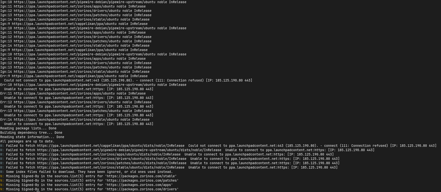

Err:10 https://ppa.launchpadcontent.net/zorinos/apps/ubuntu noble InRelease
  Could not connect to ppa.launchpadcontent.net:443 (185.125.190.80), connection timed out
Err:11 https://ppa.launchpadcontent.net/zorinos/drivers/ubuntu noble InRelease
  Unable to connect to ppa.launchpadcontent.net:https:
Err:12 https://ppa.launchpadcontent.net/zorinos/patches/ubuntu noble InRelease
Err:13 https://ppa.launchpadcontent.net/zorinos/stable/ubuntu noble InRelease
W: Failed to fetch https://ppa.launchpadcontent.net/zorinos/apps/ubuntu/dists/noble/InRelease  Could not connect to ppa.launchpadcontent.net:443 (185.125.190.80), connection timed out
W: Failed to fetch https://ppa.launchpadcontent.net/zorinos/drivers/ubuntu/dists/noble/InRelease  Unable to connect to ppa.launchpadcontent.net:https:
W: Failed to fetch https://ppa.launchpadcontent.net/zorinos/patches/ubuntu/dists/noble/InRelease  Unable to connect to ppa.launchpadcontent.net:https:
W: Failed to fetch https://ppa.launchpadcontent.net/zorinos/stable/ubuntu/dists/noble/InRelease  Unable to connect to ppa.launchpadcontent.net:https:
W: Some index files failed to download. They have been ignored, or old ones used instead.

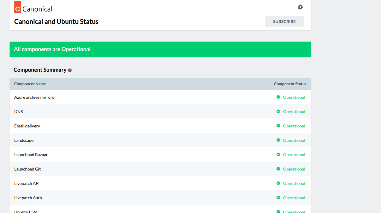

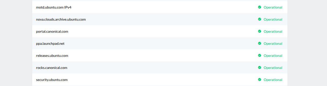

Still failing for me as well :frowning: I need to update my distro!
highly confused, says it should be up but isn't. i managed to sneak in actually getting updates that was needed, but then it went right back to this after. what the hell is going on with it? and how does the problem persist for 4-5 days? on the bright side, made me figure out how to change mirrors. As I had forgotten to do that on Zorin and was apparently on the American ones and not the Norwegian ones. not that changeing helped tho. but might help with speed when the PPA servers are actually functioning again. This is odd, and rather unfortunate.
Unfortunately, the problem is still on... I didn't know canonical was under attack...

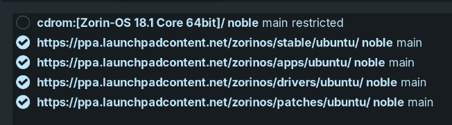

What this means:
Your system is trying to update software lists from the Zorin OS repositories (specifically for the "noble" version of Ubuntu), but the server at ppa.launchpadcontent.net is actively refusing the connection. This often happens if:
  • You are not running Zorin OS but have its repositories added to your system.
  • The Zorin servers are temporarily down.
  • Your network is blocking access to that specific IP address.

Temporary failure resolving 'ppa.launchpadcontent.net'
E: Failed to fetch https://ppa.launchpadcontent.net/zorinos/stable/ubuntu/pool/main/z/zorin-exec-guard/zorin-exec-guard_1.5.8_all.deb Temporary failure resolving 'ppa.launchpadcontent.net'
E: Failed to fetch https://ppa.launchpadcontent.net/zorinos/stable/ubuntu/pool/main/z/zorin-exec-guard-app-db/zorin-exec-guard-app-db_1.5.4_all.deb Temporary failure resolving 'ppa.launchpadcontent.net'
E: Failed to fetch https://ppa.launchpadcontent.net/zorinos/stable/ubuntu/pool/main/z/zorin-os-meta/zorin-os-artwork_1.7.10_amd64.deb Temporary failure resolving 'ppa.launchpadcontent.net'
E: Failed to fetch https://ppa.launchpadcontent.net/zorinos/stable/ubuntu/pool/main/z/zorin-os-meta/zorin-os-desktop_1.7.10_amd64.deb Temporary failure resolving 'ppa.launchpadcontent.net'
E: Failed to fetch https://ppa.launchpadcontent.net/zorinos/stable/ubuntu/pool/main/z/zorin-os-meta/zorin-os-minimal_1.7.10_amd64.deb Temporary failure resolving 'ppa.launchpadcontent.net'
E: Failed to fetch https://ppa.launchpadcontent.net/zorinos/stable/ubuntu/pool/main/z/zorin-os-meta/zorin-os-standard_1.7.10_amd64.deb Temporary failure resolving 'ppa.launchpadcontent.net'
E: Unable to fetch some archives, maybe run apt-get update or try with --fix-missing?
ghost@ghost:~$ apt-get update
Reading package lists... Done
E: Could not open lock file /var/lib/apt/lists/lock - open (13: Permission denied)
E: Unable to lock directory /var/lib/apt/lists/
W: Problem unlinking the file /var/cache/apt/pkgcache.bin - RemoveCaches (13: Permission denied)
W: Problem unlinking the file /var/cache/apt/srcpkgcache.bin - RemoveCaches (13: Permission denied)
I have checked my firewall and it is set correctly and I have changed repo locations and nothing works.
Another process is running in background (packagekitd), e.g. for automatic software updates, so that the package manager is blocked for other operations. Please wait a while and then repeat your commands. Also make sure that you are not running Gnome software center, software and updates, synaptic package manager or software updater at the same time when you try it again.
