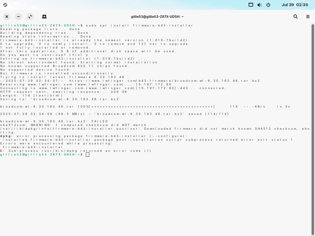

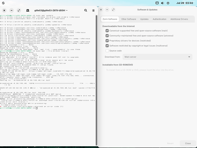

This is what I received when entering the command's, both your [Aravisian] and Forpli's solutions:

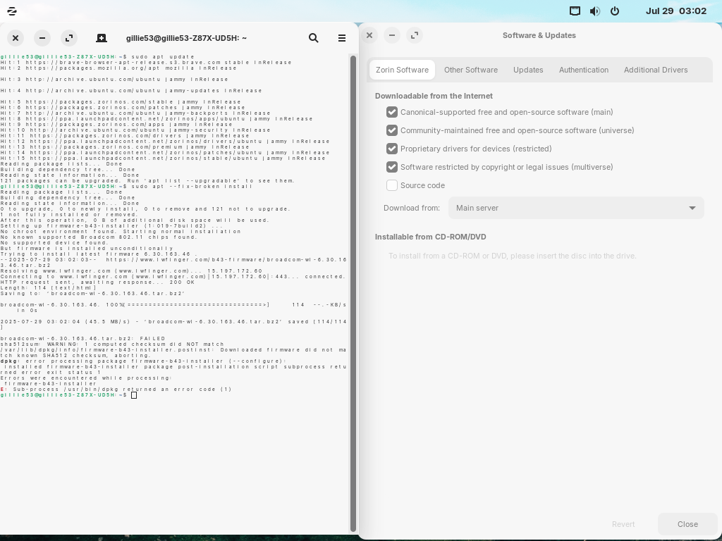

Please launch Software & Updates and on the main tab - change Download from to "Main Server."
Refresh the sources
sudo apt update
Then run
sudo apt --fix-broken install
sudo apt install firmware-b43-installer b43-fwcutter
I've changed and saved the server source as instructed. It then prompted me to refresh software sources, which I did and completed.
I ran "sudo apt update" with success, but "sudo apt --fix-broken install" returned an error:
[Only re-opened Software & Updates for screenshot]
Also, I just want to put it out there that I very much appreciate the help from the both of you! Hopefully we can get to the bottom of this.

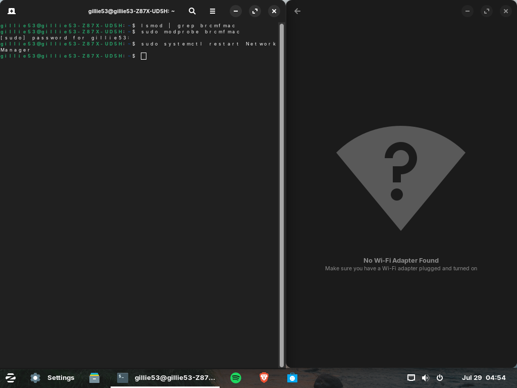

What is your terminal output for:
lsmod | grep brcmfmac
If there is no output, run:
sudo modprobe brcmfmac
sudo systemctl restart NetworkManager
Then check if there is wifi... This is being very stubborn...
I input those commands to no response. I do apologise for being a stubborn case I really do appreciate the assistance!

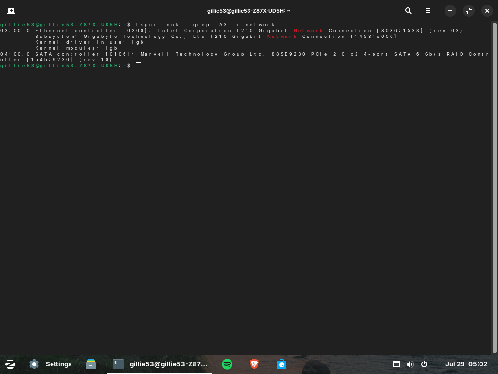

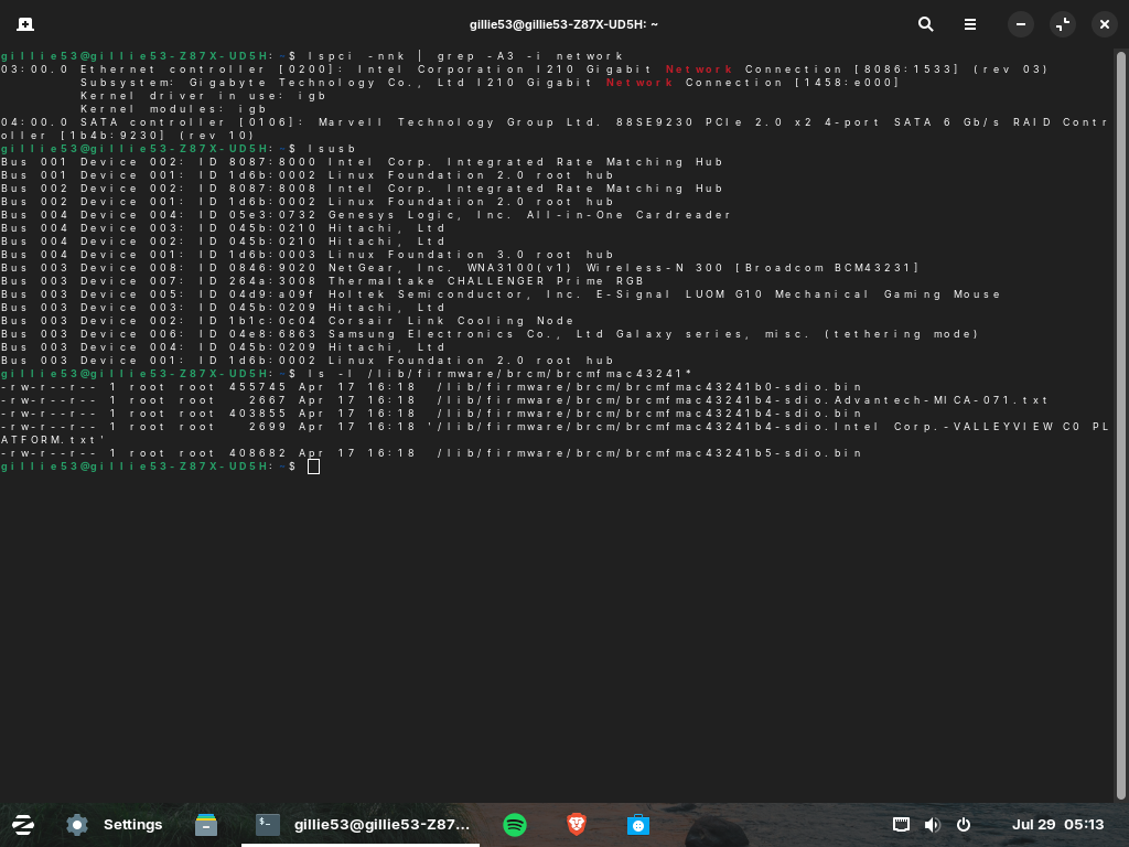

Can you post the terminal output of
lspci -nnk | grep -A3 -i network
Sorry to keep throwing commands at you...

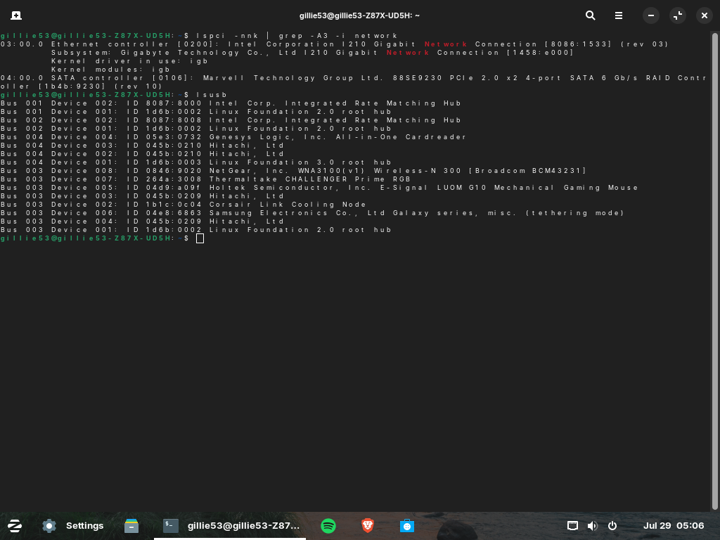

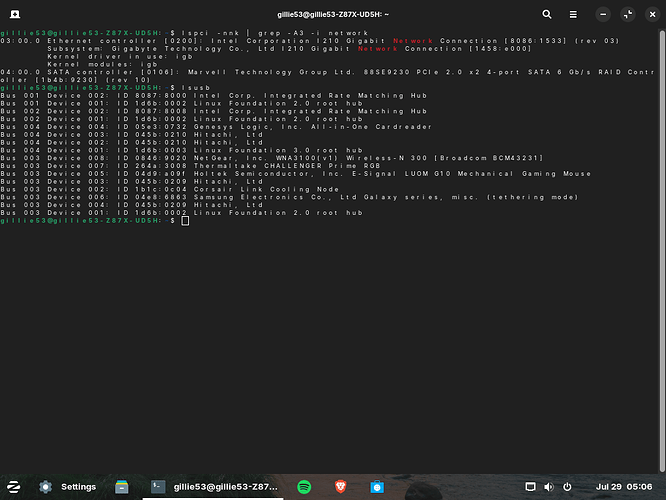

Let's try
lsusb
That's alright don't apologise, I'd rather get to the bottom of it - has to be done!
Here's response for lsusb:
We can see the device is recognized and running...
Let's check
ls -l /lib/firmware/brcm/brcmfmac43241*
This shows that the firmware is now installed, and there are no "Not found" missing files.

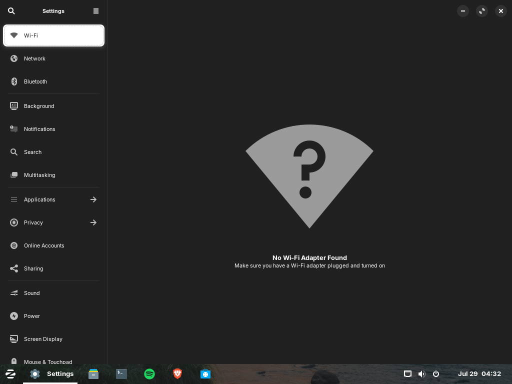

Maybe the driver is soft blocked...
rfkill list all
I input that command and didn't receive any response. I re-opened the settings and Wifi still gives the same message of "No Wi-Fi Adapter Found".
