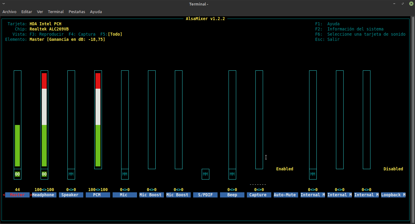

I don't know if things have moved on since your post #22 with alsamixer screenshot.
I see Speaker is set Muted [MM] move to that and hit M to unmute.
Also have a play with [Auto-Mute[ and [Loopback ] toggles.
I had to set Loopback set to Enabled to get sound working consistently on my system.
You can also unmute other channels and increase volume level to high to see any effect.

I have unmuted those before, but I will check it again and apply your suggestions
I don't use speakers, since this is a laptop , I have attached a cord for external speaker in the headphones jack.
