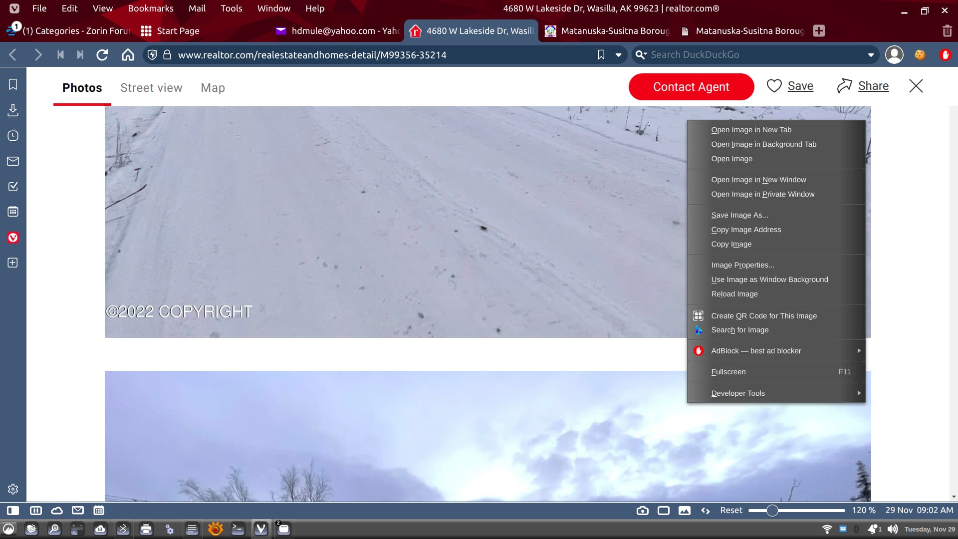

Well I tried the Back Key suggestion and it didn't work .... as usual the first photo I changed to to 1 but the 2nd photo refused to clear the current name ... it just sat there glaring at me .....
By the way I'm still on Thunar as it won't let me use Nemo unless I delete Thunar again .... not sure if that matters or not .... like I said I have deleted Nautilus also ....
In the screenshot - it is highlighted.
Was it highlighted when you hit backspace? Did you not pound that backspace key and show it who the boss is?
Yes it was highlighted .... no I didn't abuse my poor keyboard ... YET
Maybe you should...
I just tested this several times and each time - the save as dialog has the original name highlighted. Tapping backspace before doing anything else worked.
However...
I notice that in trying to replicate your issue it did not work if I tapped backspace while the Save As dialog window was not the Active Window.
That is, if you clicked anywhere else in between, it may have backdropped that window...
I'll give that a try I just have to click on the current name to clear the highlighted name ....
So I clicked on the Original File Name and the highlight disappeared but the cursor started deleting the name from right to left .... as evident by the missing bp in the extension ....
That is why you backspace while it is highlighted instead of clicking on anything.
I tried that too .... that is the first thing I did was to hit backspace but it does nothing for me in fact now the highlight doesn't disappear .... I deleted Thunar so the only file manager I have is Nemo .... should I reinstall Nautilus .... do you have it installed on your OS .... if you don't I won't worry about it .....
