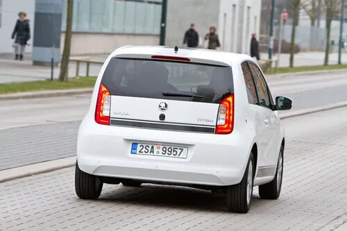

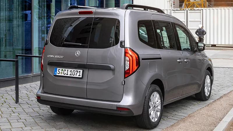

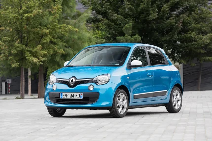

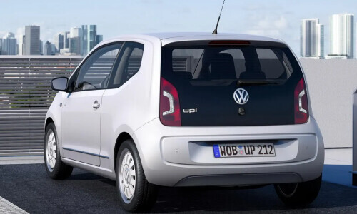

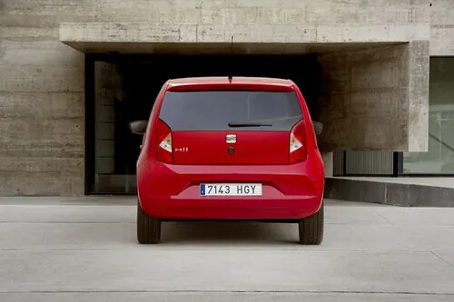

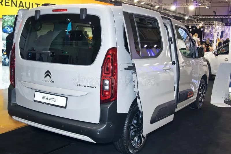

Before lockdown, we had a discussion at work how car bodies are now manufactured for different brands but basically the same.
VW Up! = Skoda Citigo = Seat Mii
Smart 4 = Renault Twingo
Mercedes Citan = Renault Kangoo = Citroen Berlingo
