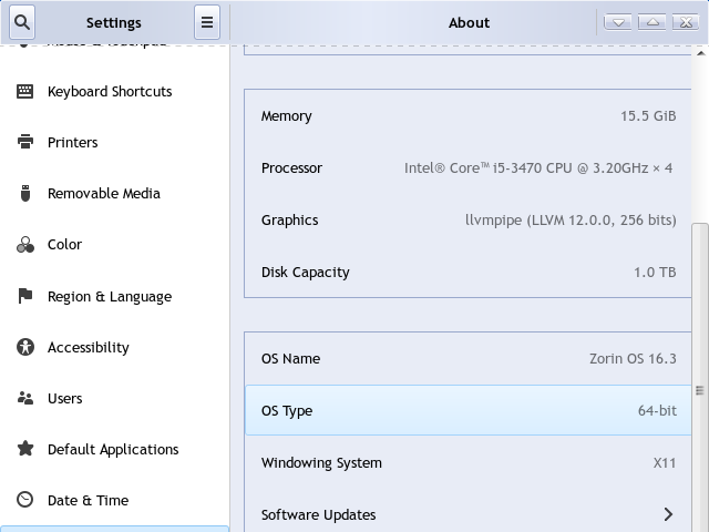

I can't even find out what my display or output is called for some reason zorin is calling my tv "unknown display"
and running xrandr too get my screen id popped up with this "xrandr: Failed to get size of gamma for output default
Screen 0: minimum 640 x 480, current 640 x 480, maximum 640 x 480
default connected primary 640x480+0+0 0mm x 0mm
640x480 73.00*
1440x1200_60.00 (0x541) 144.500MHz -HSync +VSync
h: width 1440 start 1536 end 1688 total 1936 skew 0 clock 74.64KHz
v: height 1200 start 1203 end 1213 total 1245 clock 59.95Hz
1920x1080_60.00 (0x555) 173.000MHz -HSync +VSync
h: width 1920 start 2048 end 2248 total 2576 skew 0 clock 67.16KHz
v: height 1080 start 1083 end 1088 total 1120 clock 59.96Hz"

i've had this install of zorin 16.3 since july or august.
I did install some updates but that was a day ago and everything worked and I had the pc off for a while and it still worked when I turned it back on later last night. and it was working, I turned it off, went too an appointment, and came back turned it on and was faced with this glitched display shown in the first pictures

Are you on Zorin OS 16 or 17? ![]()
Why are you showing Jammy sources?
Zorin OS 16 should only show Focal Sources.
