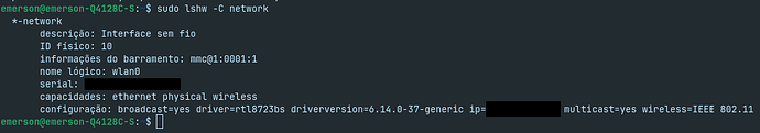

Can you please post your terminal output for:
sudo lshw -C network
That is List HardWare command - so we can see what drivers you are using, and if you need different drivers for your hardware.

Sure!

I do not see a WiFi card listed in your output. It shows your ethernet.
However, it is listed with RTL8723BS, which is a WiFi card - it is SDIO, not PCIe or USB, so might be displaying internally as an Ethernet like interface.
What that means is most likely, the included driver in the kernel is incomplete.
Using a different kernel or as different WiFi card become your most practical options.
Which, I see @Forpli has reached the same conclusion.
This is not as scary as it sounds; applying another kernel is quite easy to do. IF you prefer trying that route before trying a physical solution like a USB WiFi card, we can walk through those steps.
