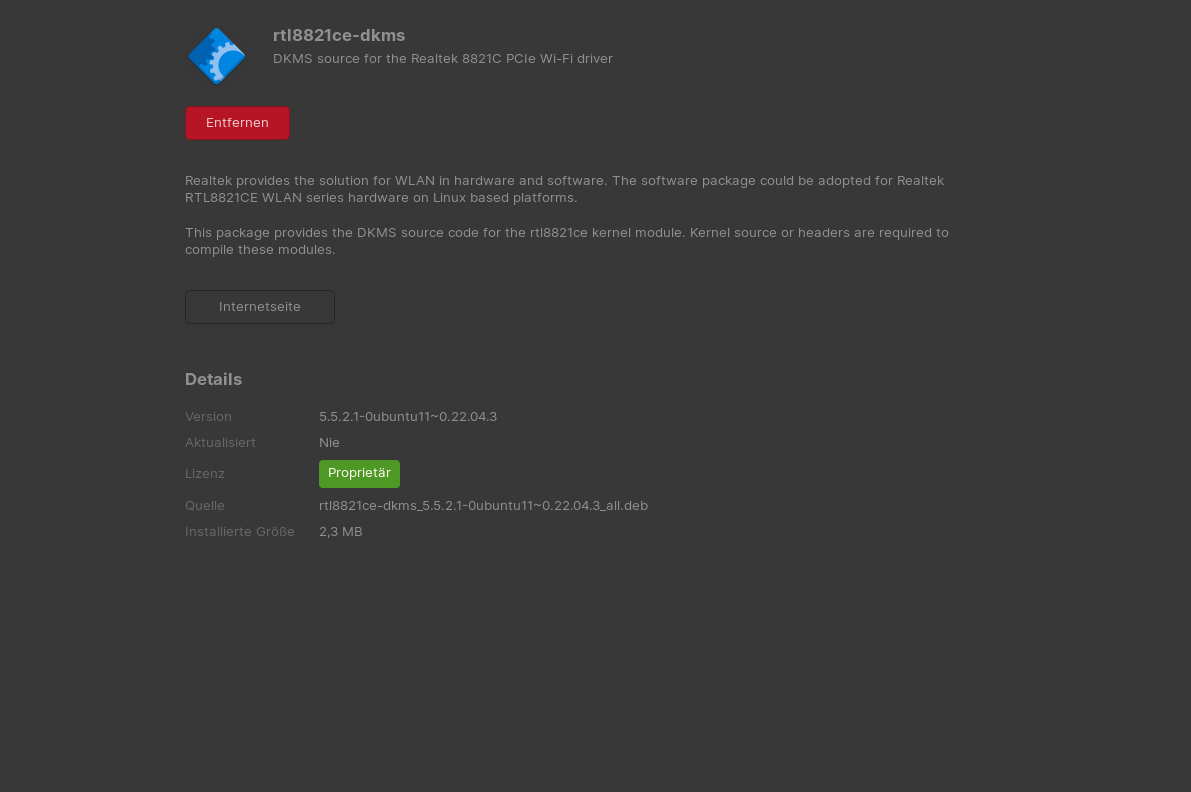

also tried another version I found over the Zorin Forum:
https://ubuntu.pkgs.org/22.04/ubuntu-proposed-universe-amd64/rtl8821ce-dkms_5.5.2.1-0ubuntu11~0.22.04.3_all.deb.html
This one opened with the Zorin Software Manager, but it stated that it's already installed:
I still don't have WiFi.
