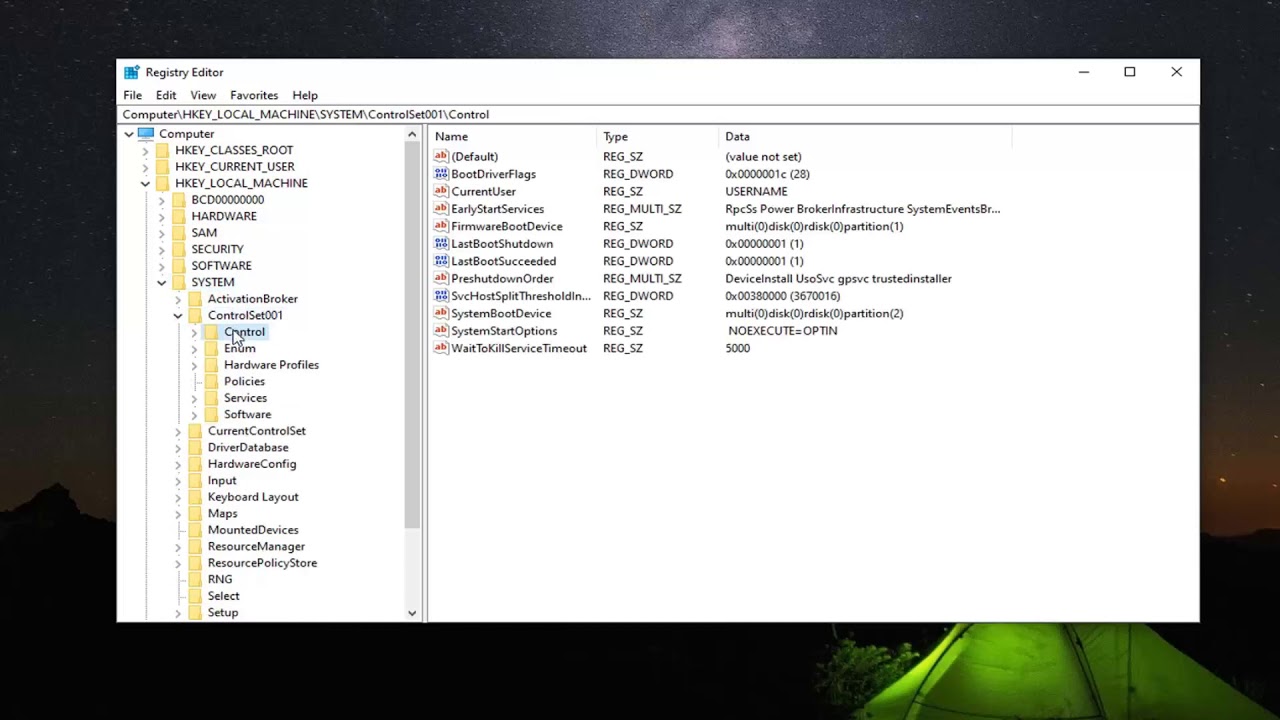

When you presumably fix this issue -- there's a minor issue which is really annoying on the Windows side. The Clock 'breaks' on the Windows side. However, and don't panic -- there's a very simple fix --
Trust me when I say if I can fix it -- it's simple.
