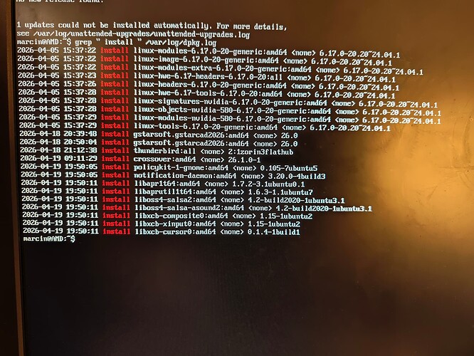

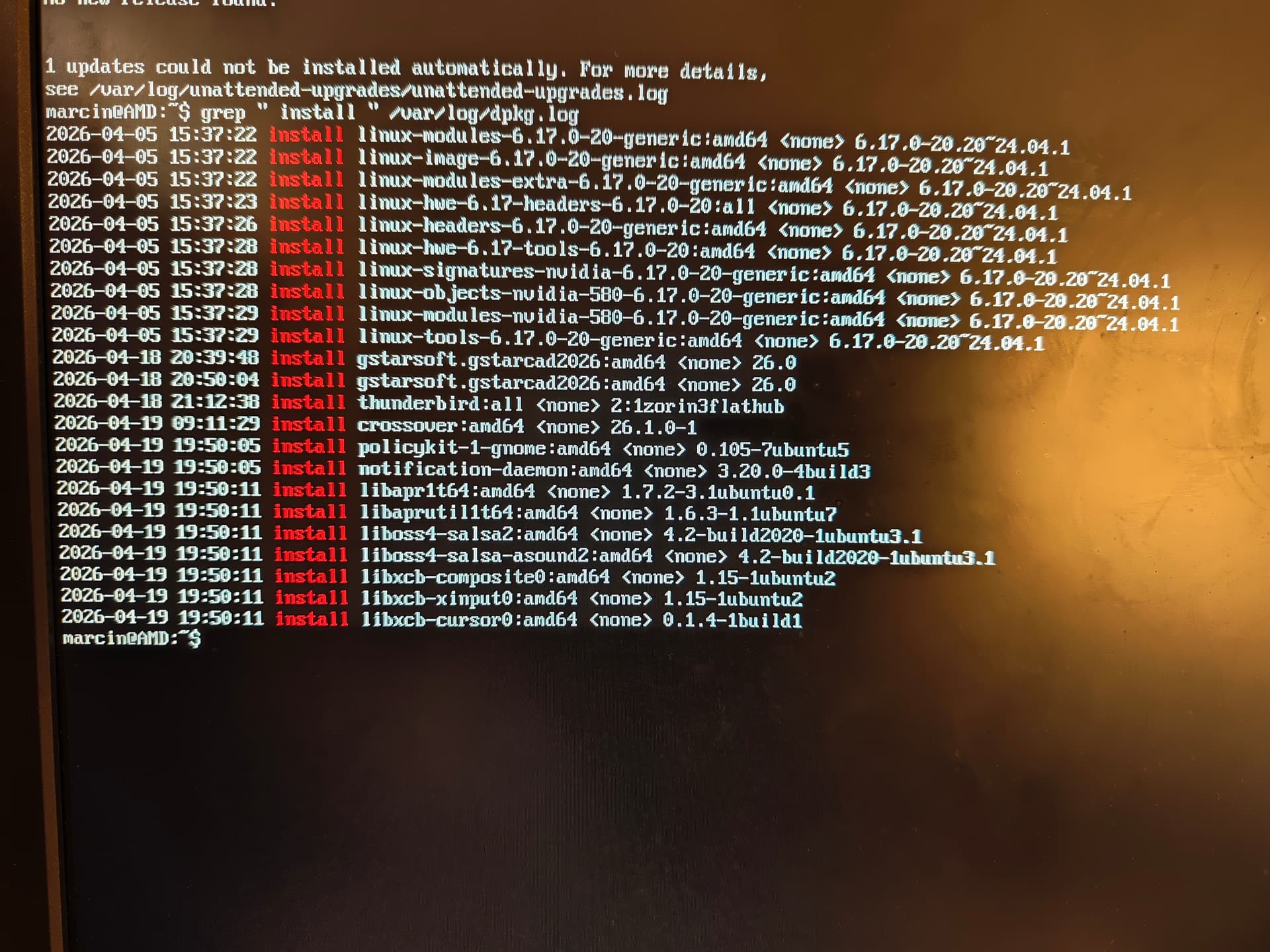

Can you check what it was you installed?
grep " install " /var/log/dpkg.log
Should I get rid all libraries installed at 19:50 and later?

I do not think that they specifically broke the system and xcb removal can actually result in further breakage.
Let's first rebuild your graphics stack and compositing

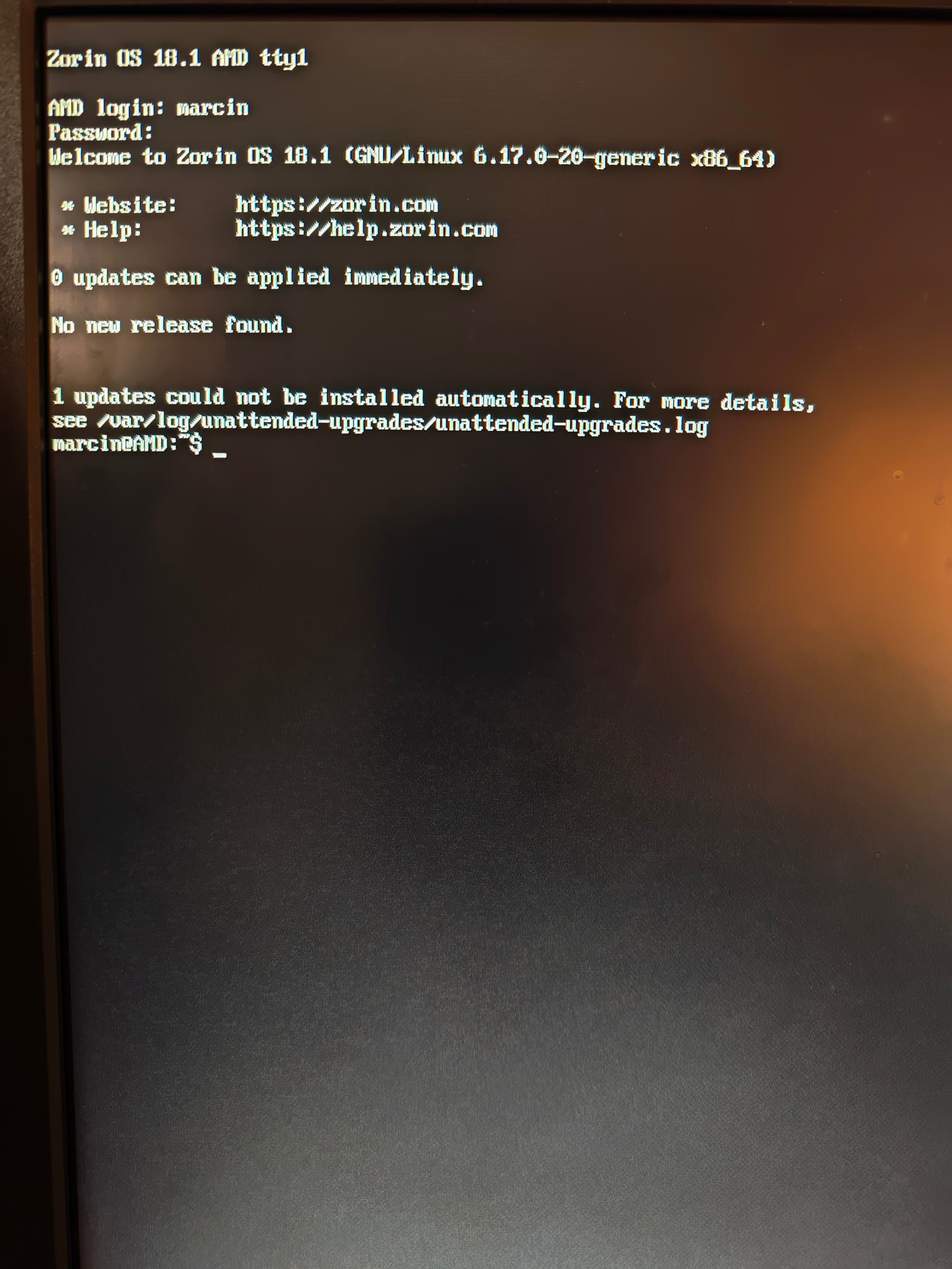

Hello, run all your commands, went successfully how ever X still won't start even after reboot.
In the picture message after loging to shell
Well, we can check what that update is, in case it is related:
apt list -u

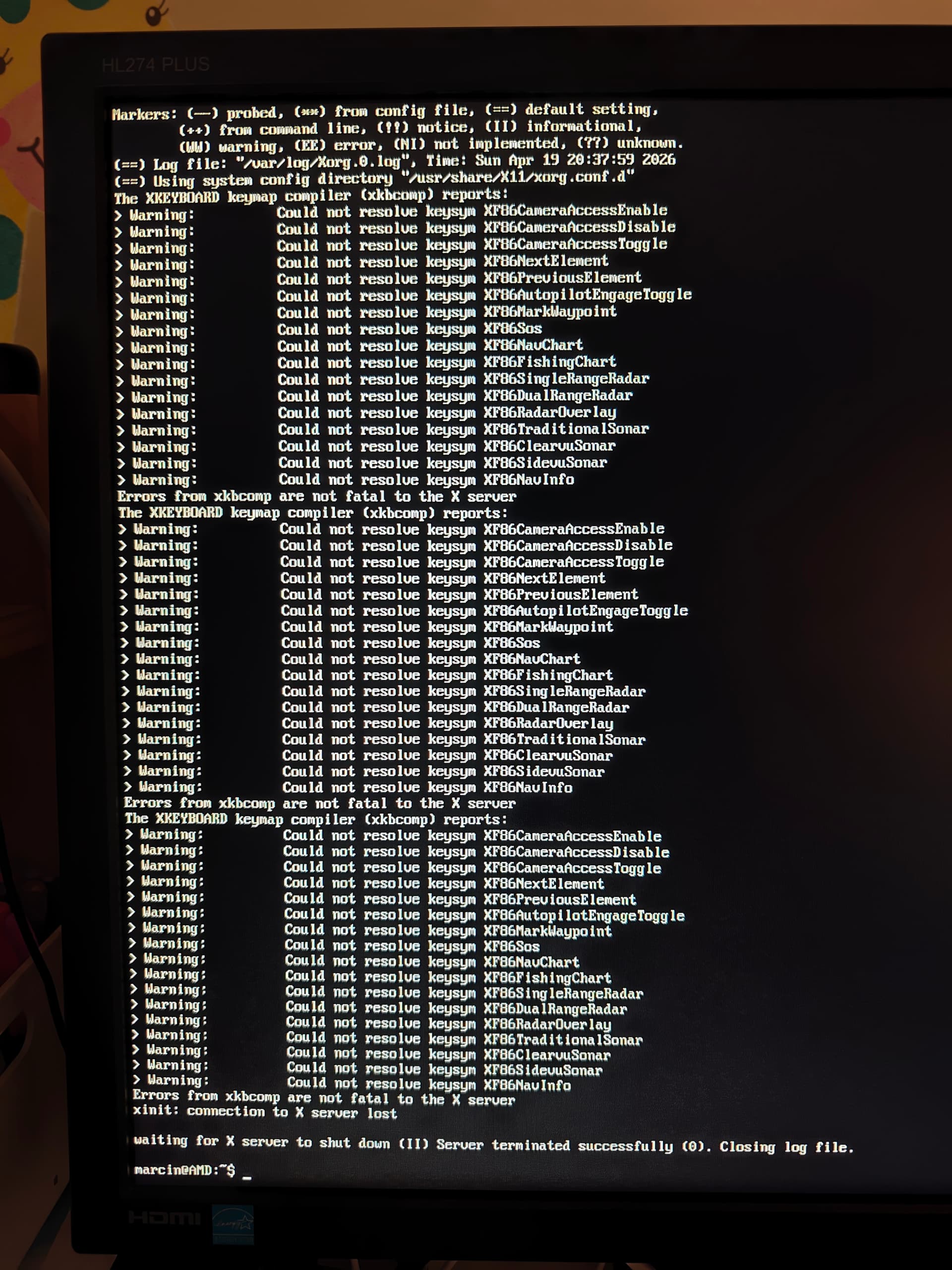

List of Warning after typing sudo startx
No return after this comand.

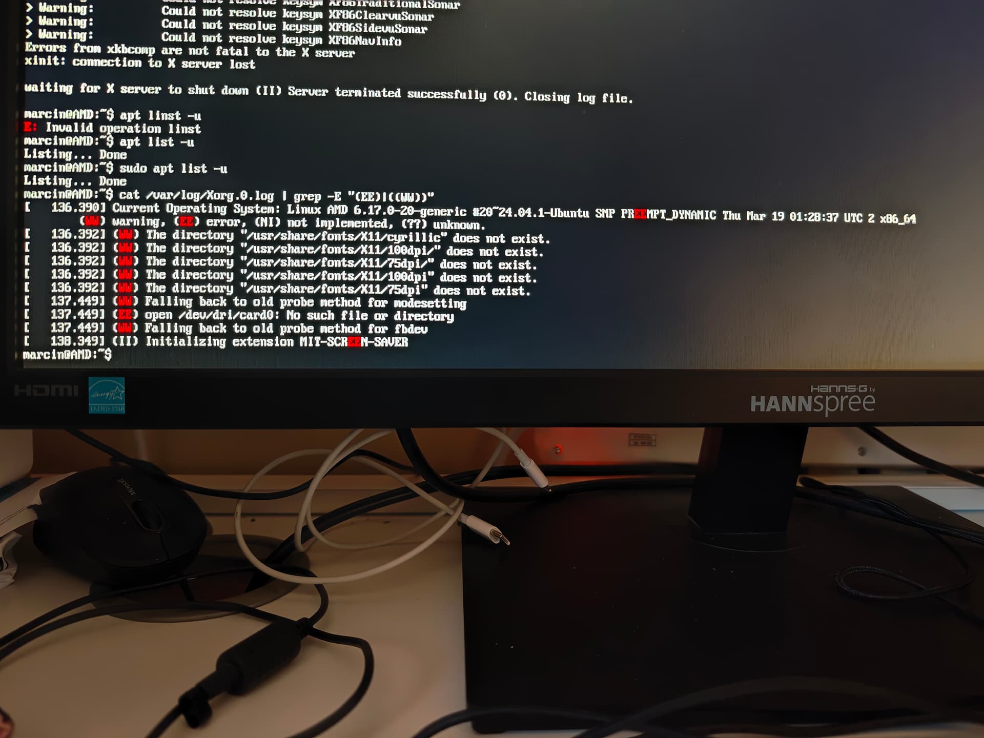

What about:

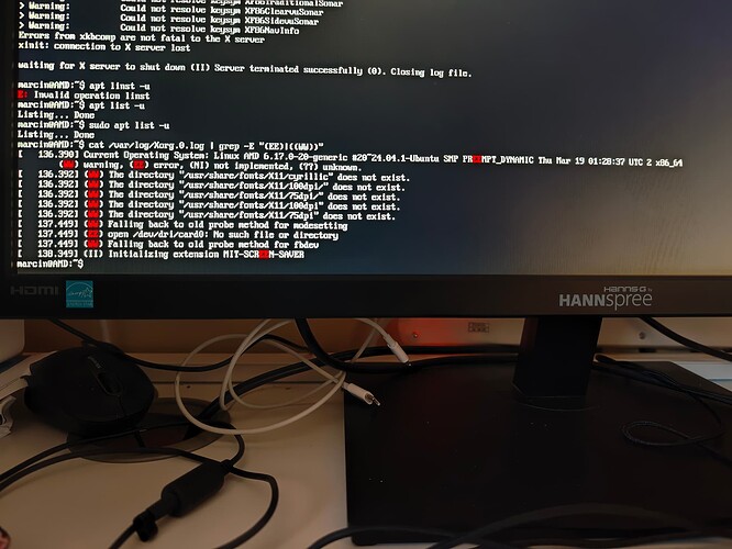

cat /var/log/Xorg.0.log | grep -E "(EE)|((WW))"
Looking for fatal errors with X...
Hmmm...
(EE) open /dev/dri/card0: No such file or directory
