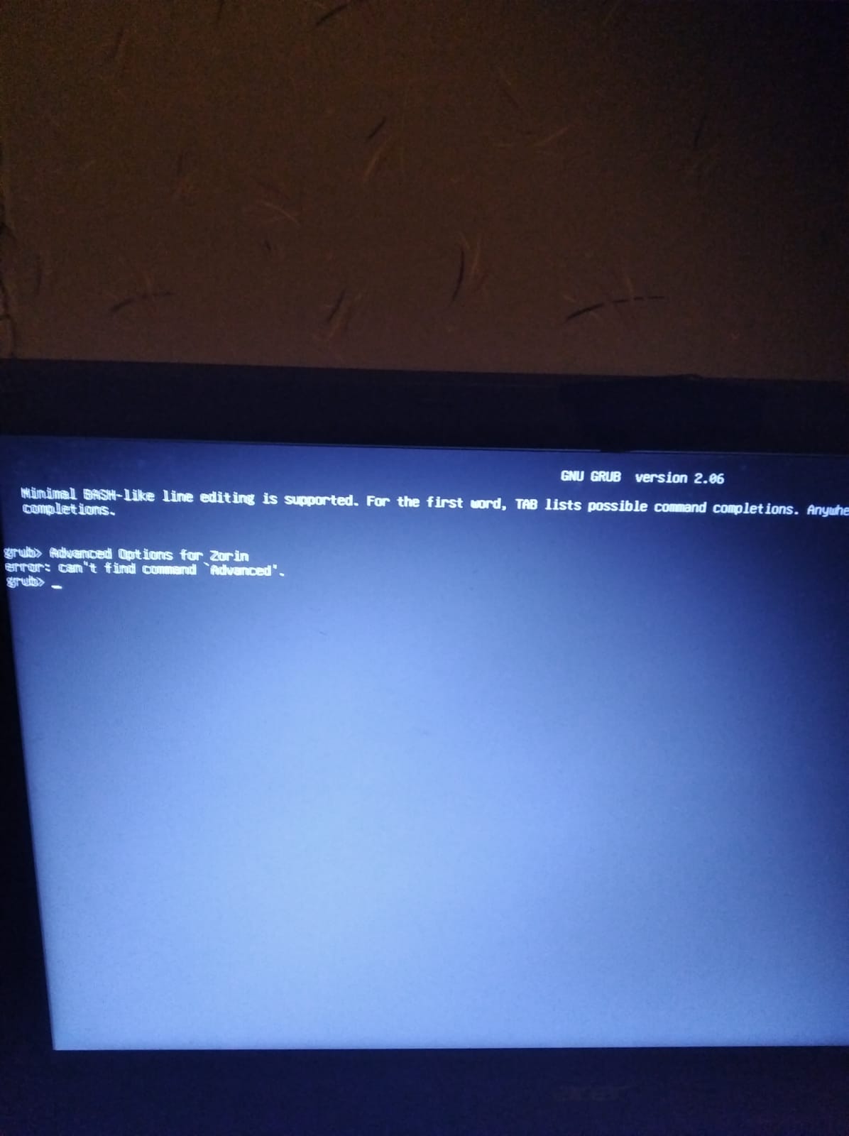

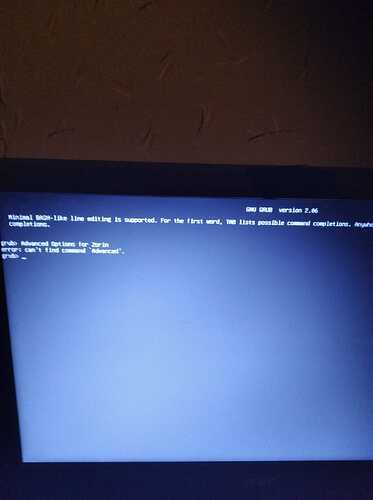

No when i start the my computer i get whole black screen?
Is there some way to reinstall the zorin desktop?
Why did you restart?!
You will now need to use Grub Menu to enter Recovery Mode. Enter the Zorin (Recovery) option. In the Recovery Menu, first arrow key to Enable Networking and enable it. Then back to the recovery menu, arrow key down to "Drop to prompt" and in the prompt, run
sudo apt install --reinstall zorin-os-desktop -y
How do i get into Zorin Recovery option?
You must reboot, then tap the esc or tab key after seeing your motherboard splash screen to pull up the Grub Menu. From Grub Menu, select Advanced Options for Zorin

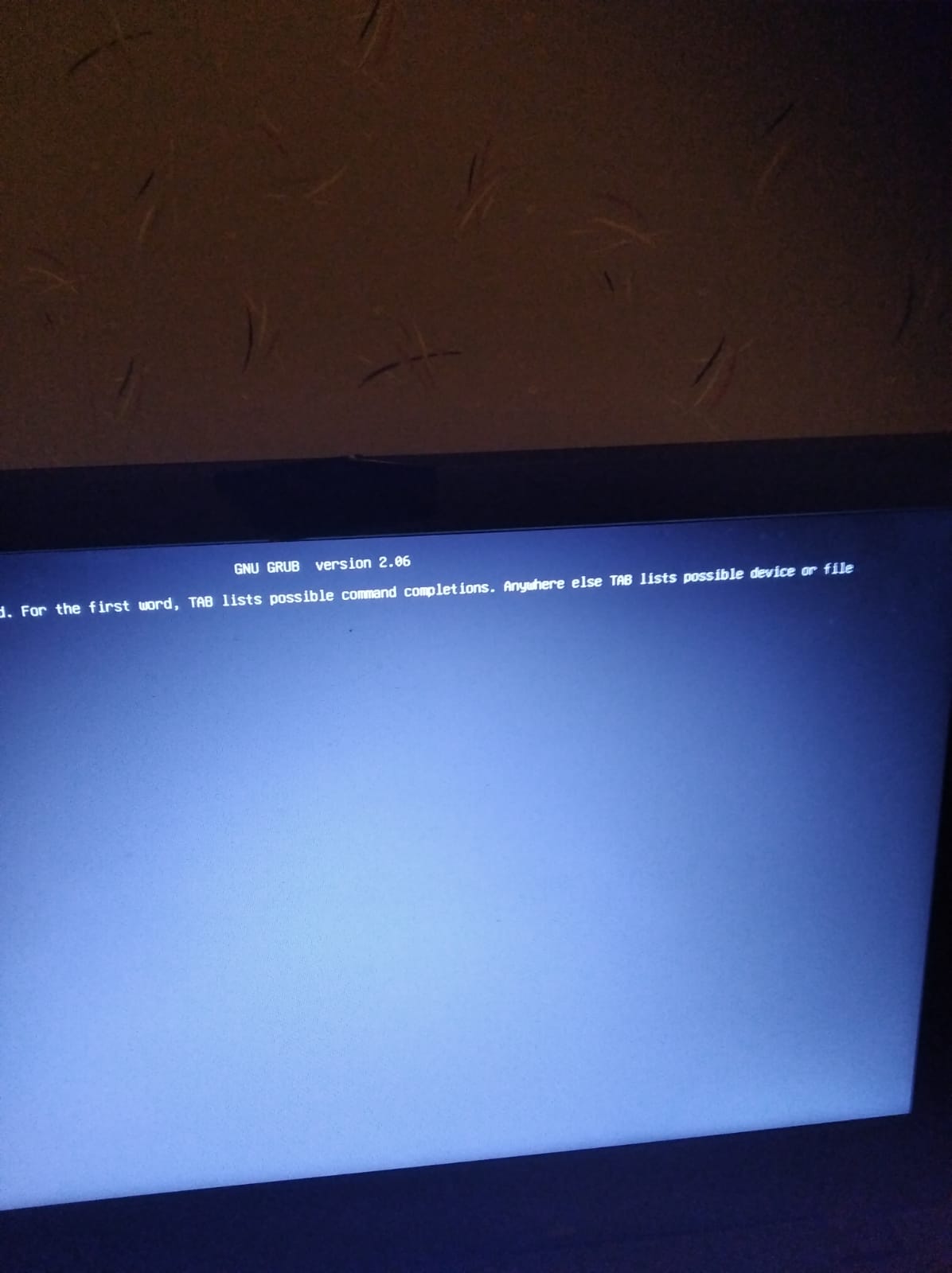

It's all black?
It may be a matter of timing. Tap the esc key like you are playing Mortal Kombat the moment you see the motherboard splash screen.
After that?
