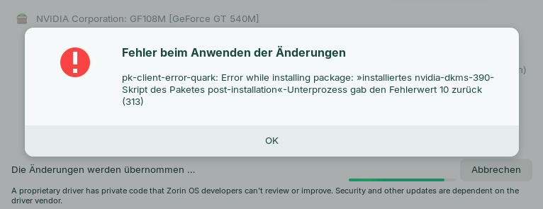

I tried to update the driver but get this error message:
Maybe it is the driver that is causing the program not to work properly, after all ffmpeg works with the gpu, i guess
