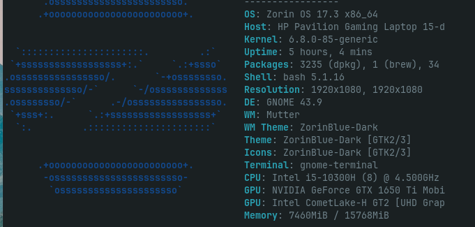

Here’s my system info for reference (from neofetch):
