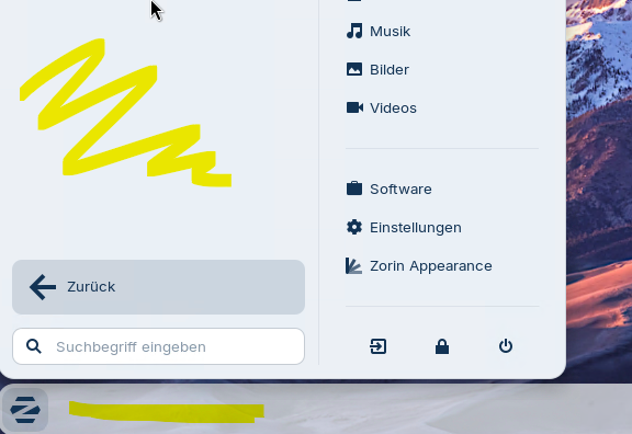

Unfortunately that did not do the trick. The users are all on the same machine. It looks like this to certain users:
To others it looks just fine. A reboot does not change a thing. Either it works right away or it does not.

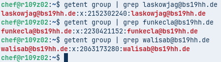

Exactly. They are all simple users in the Azure AD. No different groups in AAD. No special group in zorin:
No. Same groups in AAD and no special group in zorin. They all authenticate against AAD and are given access to zorin, if authentication is successful. Then a home directory is created and that's it, as far as I can tell. Not differences really.

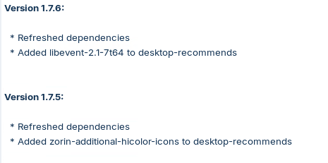

I setup a zorin 18 core beta machine and isolated the 4 updates causing the strange behaviour (sorry, German language pack):
If one of these updates is installed some of the users do not get the icons.
Here are more details about the packages:
-> gir1.2-malcontent-0 (update from nothing to version 0.11.1-1ubuntu1.2)
-> malcontent (update from nothing to version 0.11.1-1ubuntu1.2)
-> malcontent-gui (update from nothing to version 0.11.1-1ubuntu1.2)
-> zorin-os-desktop (update from 1.7.4 to 1.7.7)
I also did a fresh install of the zorin 18 core and removed those packages. After that everythings works fine for all users. Are there any problems I might run into after having removed these packages?

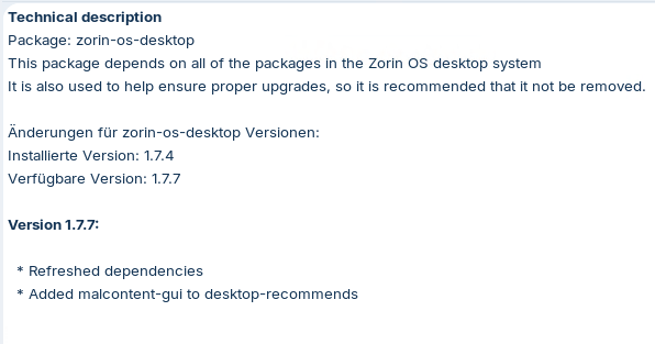

That seems to be Parental Control which shouldn't be a big Problem to not have it. But the last Package ''The Zorin OS desktop system'' could be a Problem depending wht it includes.
It could be related to the Parental Control Stuff for Implementation in the Desktop; then it shouldn't be a bigger Problem. Could You click on it and show the Details in the bottom Half?
This is, what you meant?
