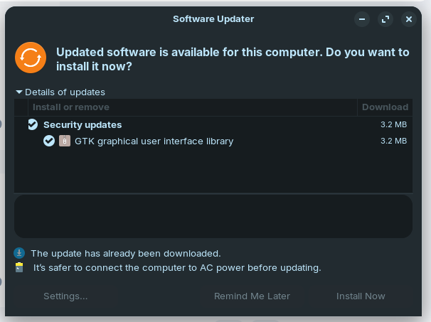

Zorin 18: The Package System is broken
Im having the following error when i try to update using the Software Updater:
The Package System is Broken:
Check if you are using third party repositories. If so disable them, since they are a common source of problems.
Furthermore run the following command in a Terminal: apt-get install -f
Transaction failed: The package system is broken
