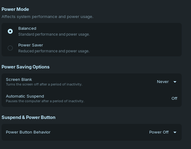

Okay. Could You post Screenshots from Settings>Energy and Settings>Privacy>Display please?

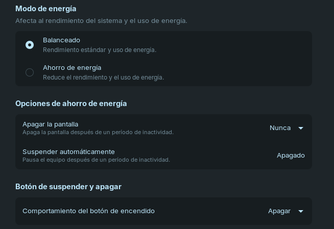

Only to confirm that:
Nunca: Never
Apagado: Off
Apagar: Shutdown/Turn off
Is that correct?

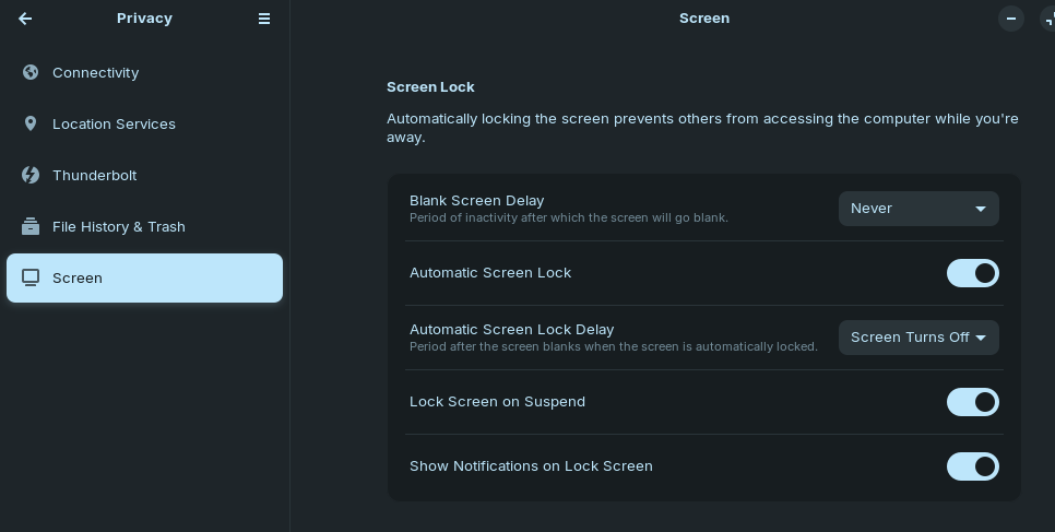

And how looks that in Settings>Privacy>Display?
Here?
Yes, right. And Thank You for switching the Language. that looks so far good to me. You could try it with disabled ''Automatic Screen Lock'' and ''Lock Screen on Suspend''.
