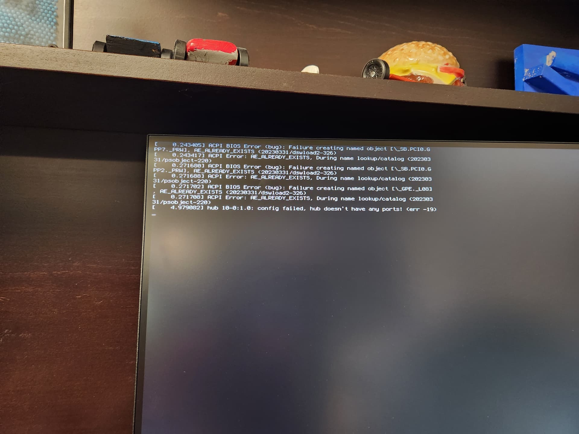

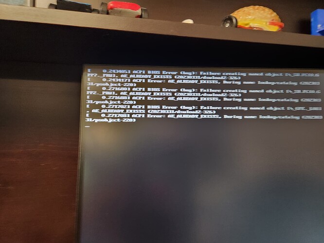

So i got rid of anything mentioning security whatsoever, TPM CSM, secure boot, and check to make sure RAID was off. there are some errors that show before getting to the zorin select screen, if this isn't normal i can send photos
What errors?
I'll take a photo and send it, i've got to charge my camera
This is normal, so if you let it run past these's errors does Zorin OS boot up?
