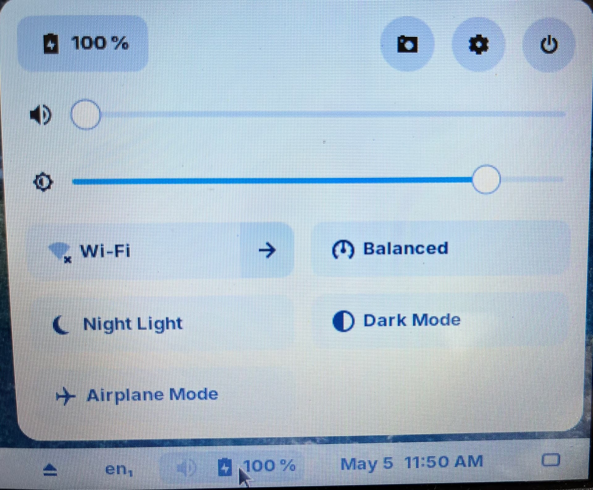

Thank you. I tried your suggestion a number of times, rebooting in between, but unfortunately it didn't help. The commands worked because they'd turn on and off the Wifi botton in that little panel (photo) at the lower right but it would never find the wifi adapter. I also noted that when it rebooted it always turned on the Airplane Mode button and turning it off didn't help.
