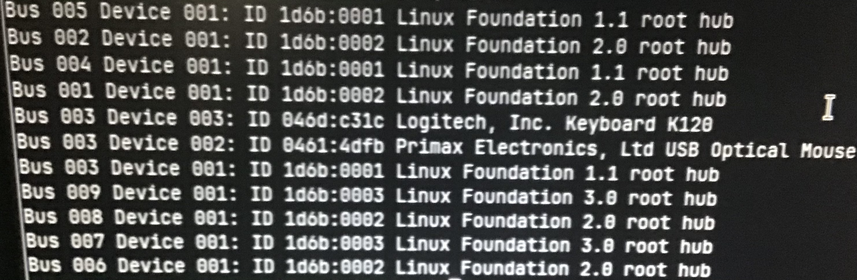

I’m not sure if it’s a bcm wireless device I just see Ethernet controller: Broadcom inc. and that’s when I use lspci

Just another possibility.. Have you opened the tower to check the presence of a WiFi device?

I’m just using the keyboard that was with it when I went to collect it and the additional drivers thing shows nothing and I haven’t opened the tower I’m not sure where I would find a Wi-Fi presence also when u has zorin 15.3 that’s when I first got it, the Wi-Fi was working fine until I started getting some error so then I installed 16.3 lite and now I got no wireless Wi-Fi so I’m not sure
