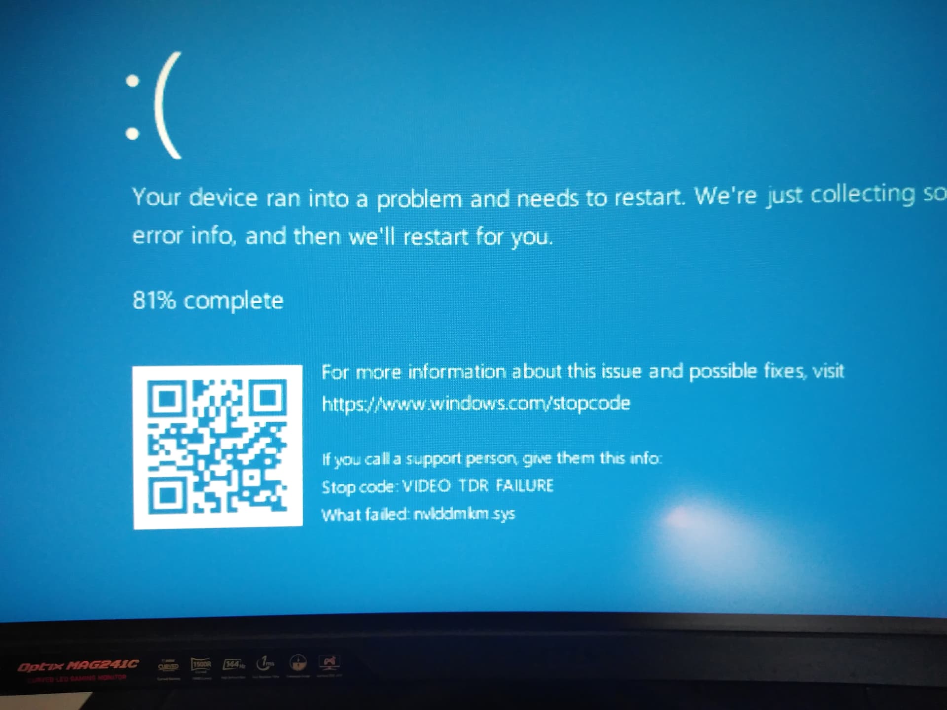

Hey @Aravisian,
This is the blue screen I get
Explaination of Windows TDR BSOD here:
https://www.makeuseof.com/video-tdr-failure/
