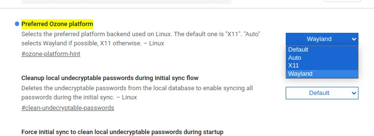

You need no terminal commands to switch to Xorg. Logout and at login click on your username, then a cog wheal appears at the bottom right of the screen. There select "Zorin Desktop on Xorg". Afterwards login with your password. This setting will be kept until you change it back to Zorin Desktop (which uses Wayland).
To set flags you can go to the flags settings in your browser. These pages are a bit older but I think the options are still there:
Thanks for the info.
But, after going through Xorg, I found this two-step solution (on the beta of Zorin 18):
