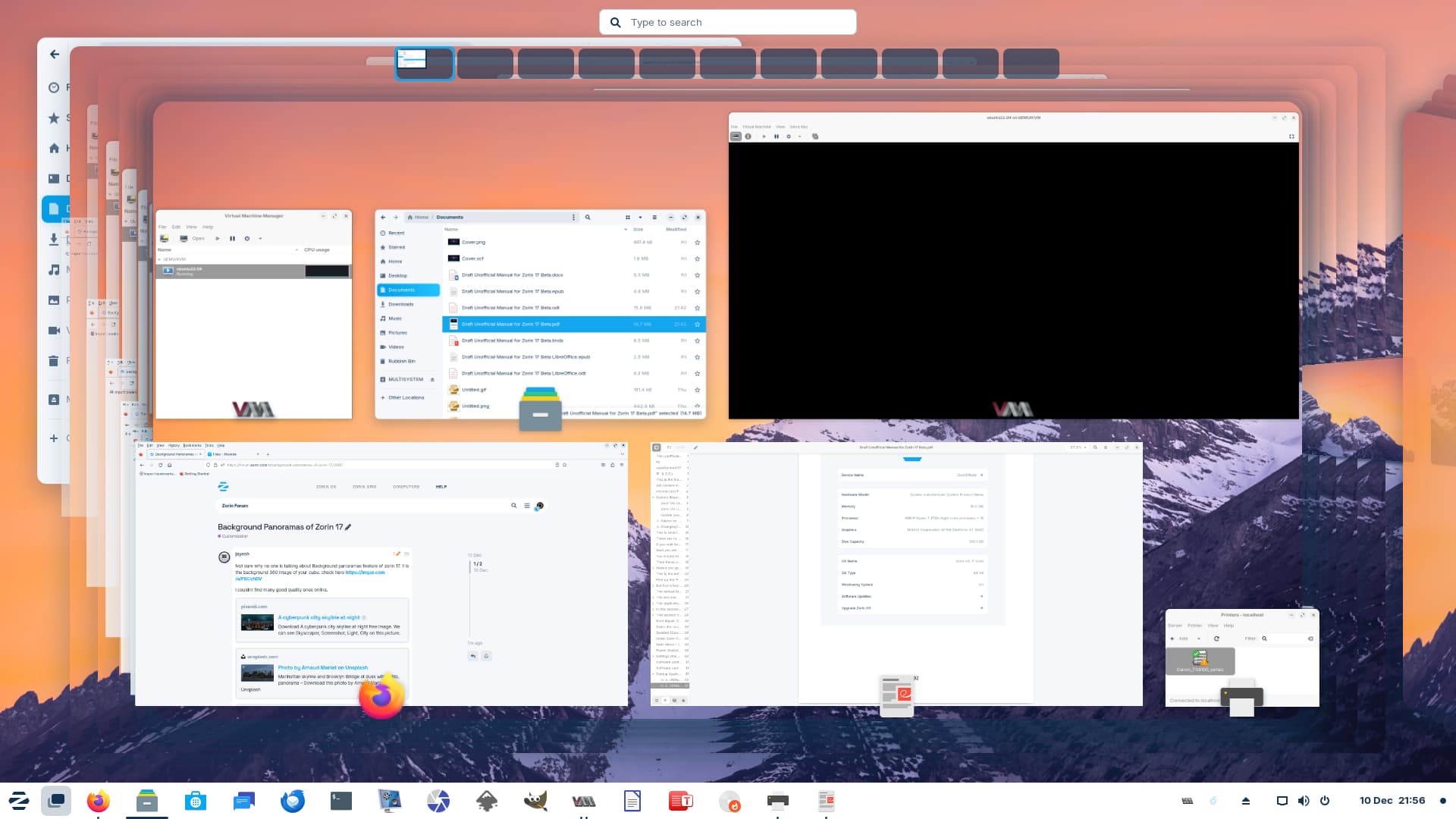

Getting some jittering of images when using Activities Overview button:
Graphics card is a Zotac nVidia GeForce GT1030 with 2 Gb GDDR5 RAM.

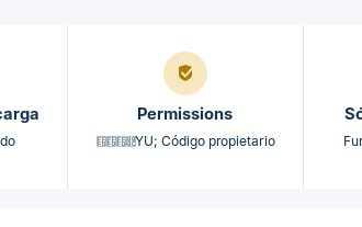

First bug I got so far in the new gnome software store: garbage text in the permissions box. Not a huge problem, since the pop-up with the details that shows up after clicking on it does seem to display all the text fine

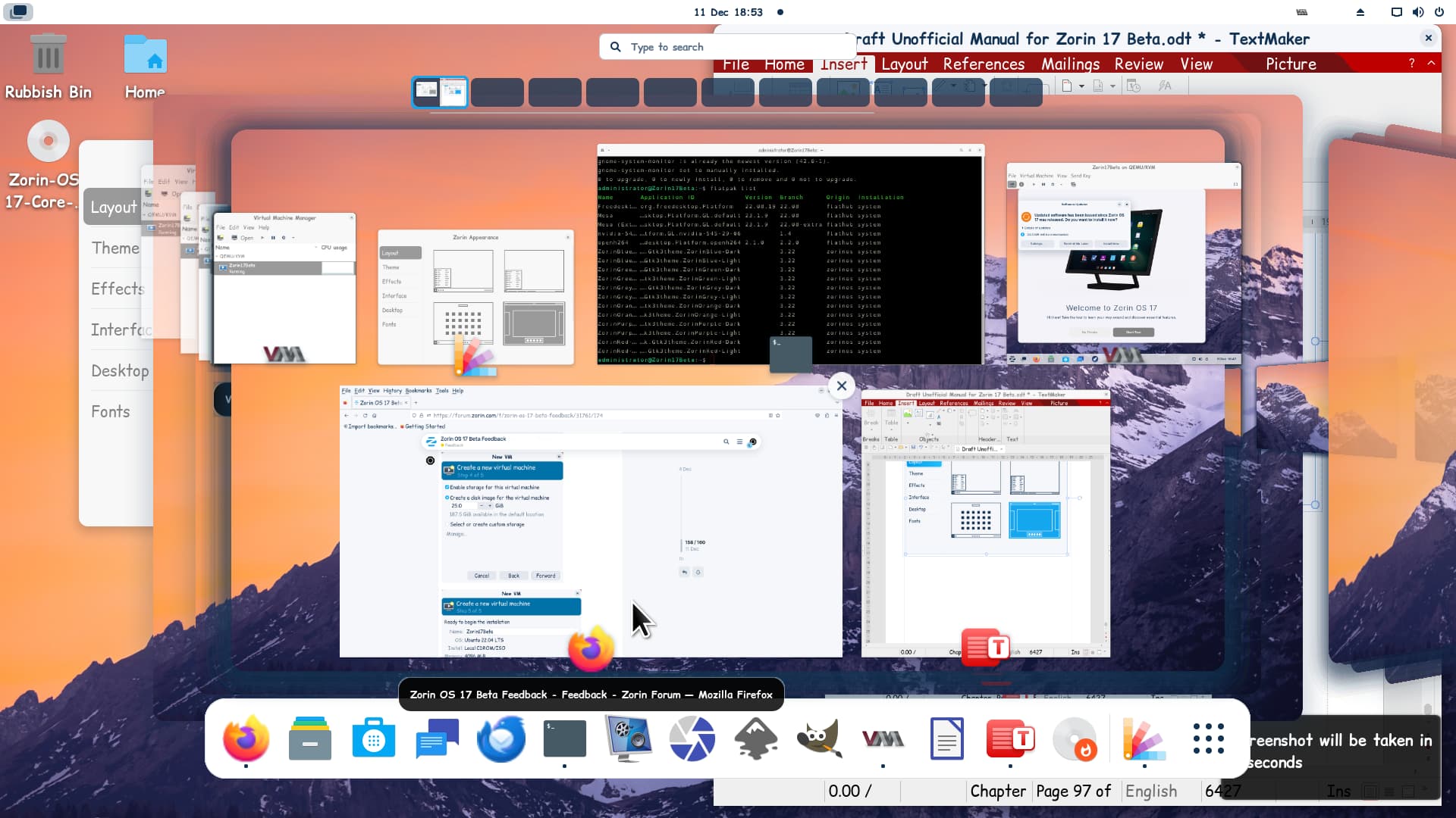

Graphical issues with Zorin Appearance. The Beta 'Take a screenshot' application does not have a timer, so I have installed Shutter. I am just in the middle of going through Zorin Appearance for the unofficial manual for Zorin 17 Beta when I discovered some glitches. The glitches can be pinned down to the Compiz elements (having Spatial desktop active, plus cube etc.) This morning whilst looking at Layouts in Zorin Appearance I got this screenshot:
The window behind Zorin Appearance appears to be an amalgam of different applications open at the time. A similar thing happened whilst taking a screenshot of the Pantheonesque Layout with the Applications Grid (not taken a screenshot of that as it was just garbled - to take a stable image I had to turn off all animations.
The last Layout I found unworkable, as it is supposed to be a Gnome layout. The Dash at the bottom of screen ony appears if the Activities Overview
button is selected and the only menu option is to select the Grid that appears on the Dash to view the Grid Menu which is going back to the Pantheon style desktop.
Basically, (personally) I find this layout unworkable and confusing, but each to their own! It appears to inherit the previouis layout in a strange way.

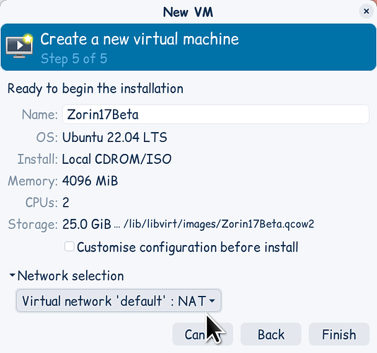

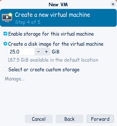

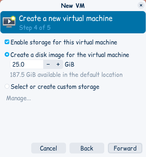

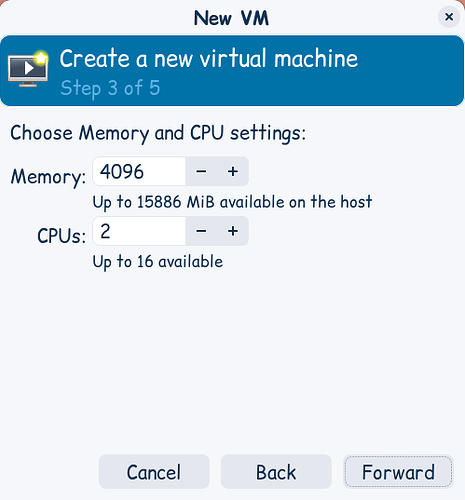

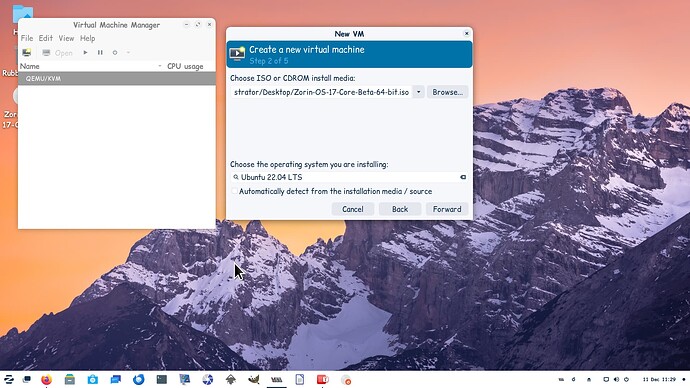

This is virt-manager screenshots from creating to looking at the Details (Hardware) of the VM:

I'd assume that's a driver issue.
if you're using proprietary drivers, try nouveau (and vice-versa)
Having checked what is running it is using proprietary nvidia driver. In earlier versions of Zorin, the graphics driver could be chosen separately from restricted codecs - you don't get the option to not select proprietary drivers or able to select restricted extras (codecs) separately like in earlier versions - that is the only reason proprietary drivers got installed. Have reverted to Nouveau drivers, still to test. Notice that the 'Cube' software is getting an update today in Updates.
Update: Using Nouveau resolved the multiple screen tearing! Oh nvidia, how I hate thee now!
