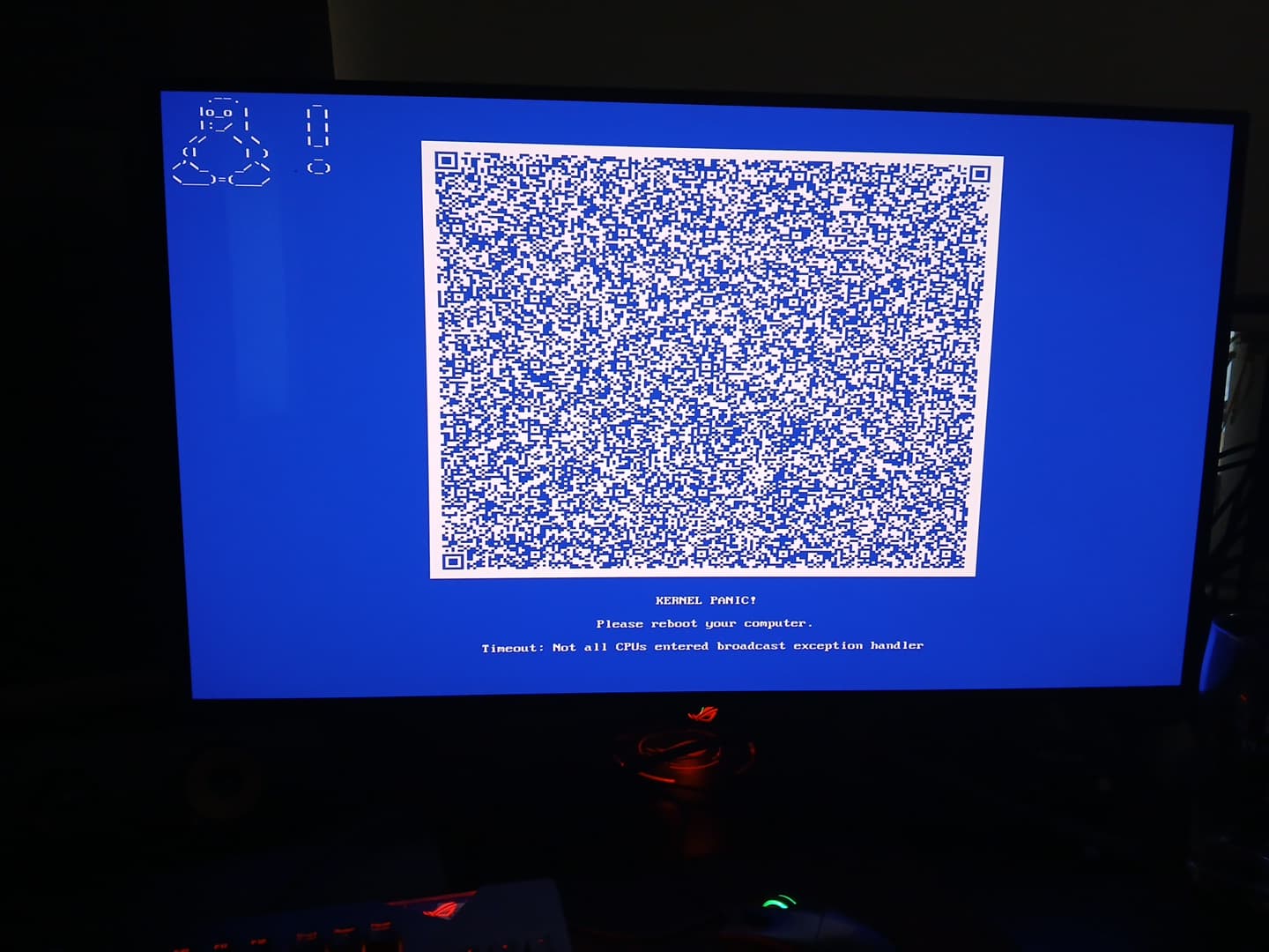

Initially I had kernel panic messages such as:
"Timeout: Not all CPUs entered broadcast exception handler"
After using "intel_idle.max_cstate=0" and disabling the Intel iGPU, the system boots much further, but it still hangs before the desktop appears.

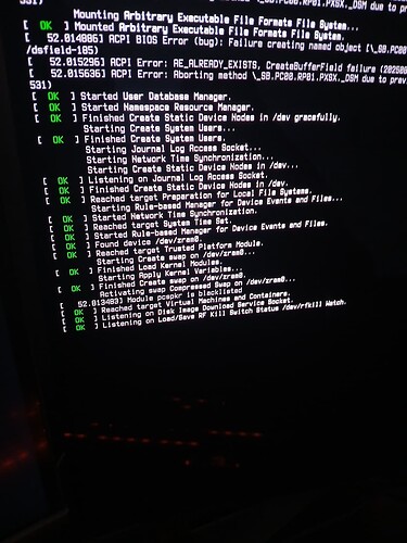

I tested again and noticed something new.
The cursor eventually stops blinking completely and the system appears to freeze.
I also noticed ACPI BIOS errors during boot:
ACPI BIOS Error (bug): Failure creating named object
AE_ALREADY_EXISTS
ACPI Error: Aborting method ...
This seems to point more towards an ACPI/firmware issue rather than only a graphics driver problem.
Does this look like a BIOS compatibility problem on the ASUS Z890 Hero?

Interesting update:
I downgraded the BIOS from 3202 to 3103 for testing.
With BIOS 3103 the situation is actually worse. I now get the original kernel panic again:
"Kernel panic - not syncing: Timeout: Not all CPUs entered broadcast exception handler"
With BIOS 3202 the system was able to boot much further before freezing.
So at the moment it seems that BIOS 3202 improved the situation rather than causing it.

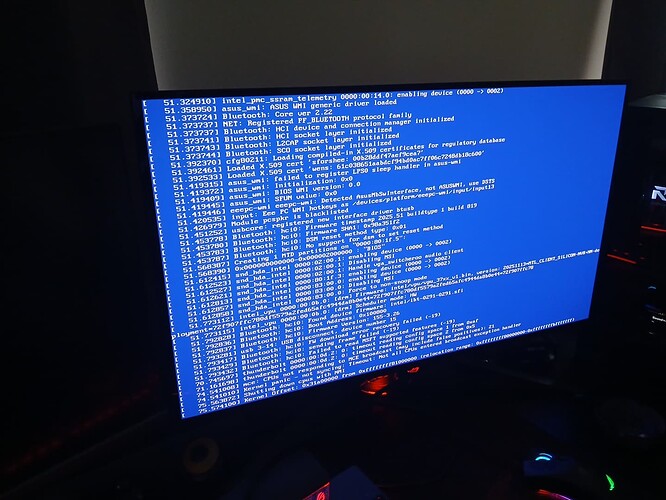

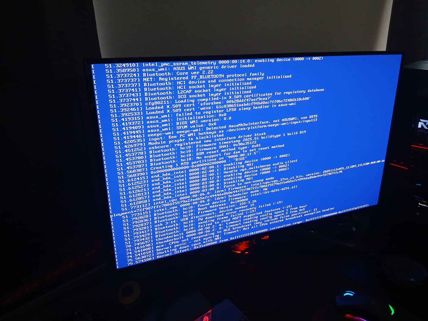

Here is a picture i had with xmp enabled
