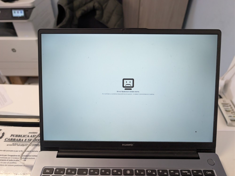

Ho aggiornato a Zorin 18 pro sembrava andare tutto bene ma niente esce scermata di errore come da allegato, qualcuno ha avuto un problema simile e ha risolto??
Ho un Huawei matebook con i5 12 gb ram e 512gb di ssd, uso con dual boot

I am sorry you are having trouble. Please try entering Recovery Mode. You can do this by rebooting your PC and pressing "SHIFT" on your keyboard repeatedly until you hit the recovery mode screen. Select Zorin OS 18 in recovery mode and see what happens. Please report back here.

Ho provato in tutti i modi ma non parte rimane bloccato su quella schermata, ho fatto le seguenti prove dette da gemini:

E ninte da fare sto preparando un istallazione pulita da poter reinstallare il sistema operativo
Are Secure Boot and Fast Boot in BIOS disabled?
I ran into the same problem with my laptop. It seems to be related to lack of WiFi connectivity. I connected by laptop using an Ethernet cable and rebooted the system.
This time the system downloaded a number of files and the upgrade went smoothly after that.
Maybe this can help:
I think I remember the original installation instructions for Zorin 17 saying to have an ethernet cable connected if possible when starting the process. That's probably why.
