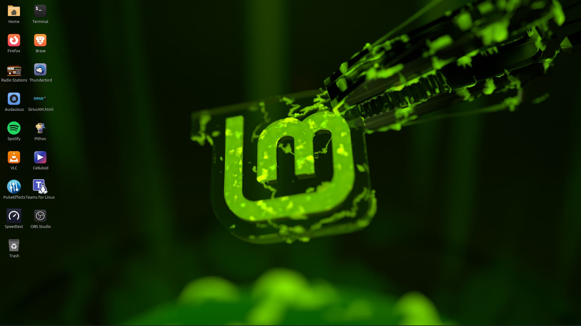

Thanks once again Zor...I thought it was over for my Zorin Machines...BUT...
Works great on my Desktop and running Noble 24.04 and I can use the built in Cinammon Display or Wayland (Experimental with no problems). I also did a restore to my 17+ year old Fujitsu Laptop with 4GB of RAM and almost everything on my Desktop ran on the Laptop with the Exception of Spotify and OBS so I just made a Shortcut on the Desktop for the laptop to run Spotify in the Browser (Custom Icon with Spotify exactly the same as the Program). Just wanted to say thanks again for the help and pointing me in the right direction.
