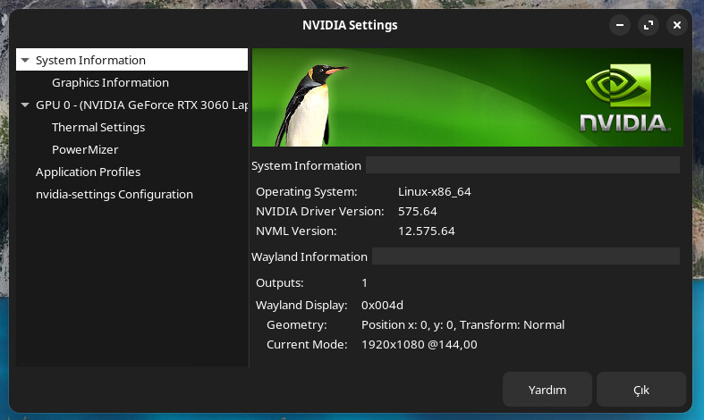

Thank you for your suggestion.
I followed your advice and installed the latest NVIDIA driver, version 575. This has changed the boot behavior, but unfortunately, the underlying problem isn't solved.
Here's what happens now:
The freeze point has shifted. It now gets stuck right at the moment the graphical Zorin logo transitions to the "Zorin" text screen.
Also, my F8 workaround method is no longer reliable. It has become very inconsistent, and I just had to reboot three times before it managed to get to the desktop.
It seems the conflict still exists, but it has moved to a later stage in the boot process, probably right before the login screen should appear.
Given this new behavior, do you have any other ideas I could try?
Thanks again for your help.

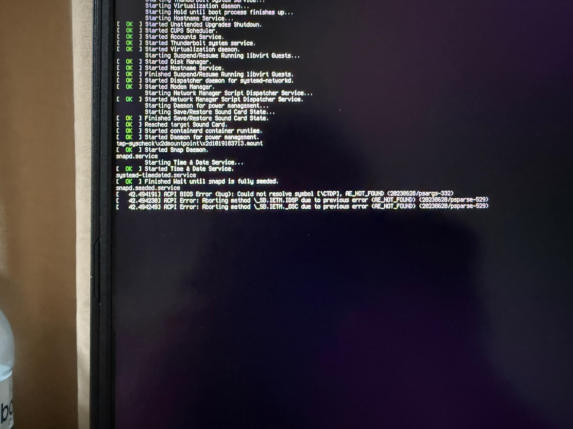

I am also sharing a photo of the last lines of text on the screen from when it fails to boot.
You have a 3060. I would make the Suggestion to try it with the 535 Driver instead.
Ugh. I hate offering you "maybes," especially when you're on a limited data plan, but have you tried updating your BIOS or kernel? I ask because those last lines are ACPI errors that, when I look around, appear to either be due to a bug in the kernel or poor implementation of ACPI. I don't want to give you too much hope on these possibilities, because the searching I did also implies that this error is normally non-fatal, which implies it could be dying right after those, but before the next line of text can display. :confused:
