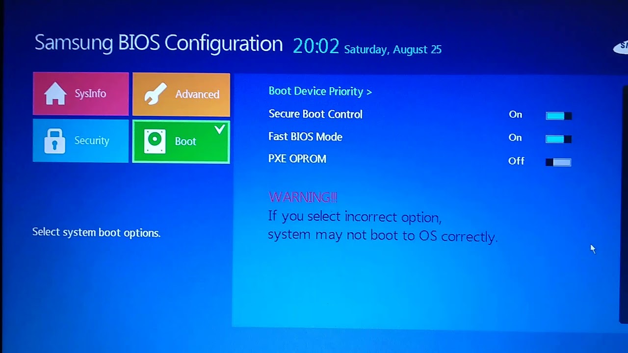

But my biggest problem is that my bios is VERY limited for anything, because of Samsung. My notebook is Samsung X40 from 2018/2019, and in the bios there is no RAID option for ACHI or anything like that.
Yep, that would be the problem...

The worst part... in the bios there is no way to change RAID to AHCI. There are no options for almost anything...
Is the setting currently on RAID?
Is it possible to take a photo of your BIOS settings pages with a mobile phone? I am very curious to see it.
I remember that the original BIOS came with our old Acer Aspire had a notorious InSyde H2O and next to impossible to change anything. One reason I took a chance and flash it with a mod BIOS to remove those restrictions.
Here is a video I found on youtube that shows well the bios. Sorry for the delay and hope it helps this video. I'm actually testing going by the "Windows way" than trying to have another bios and being able to destroy my machine.
I believe so but I can not say for sure because there is no way I see or change the configuration from RAID to AHCI or something like that.
