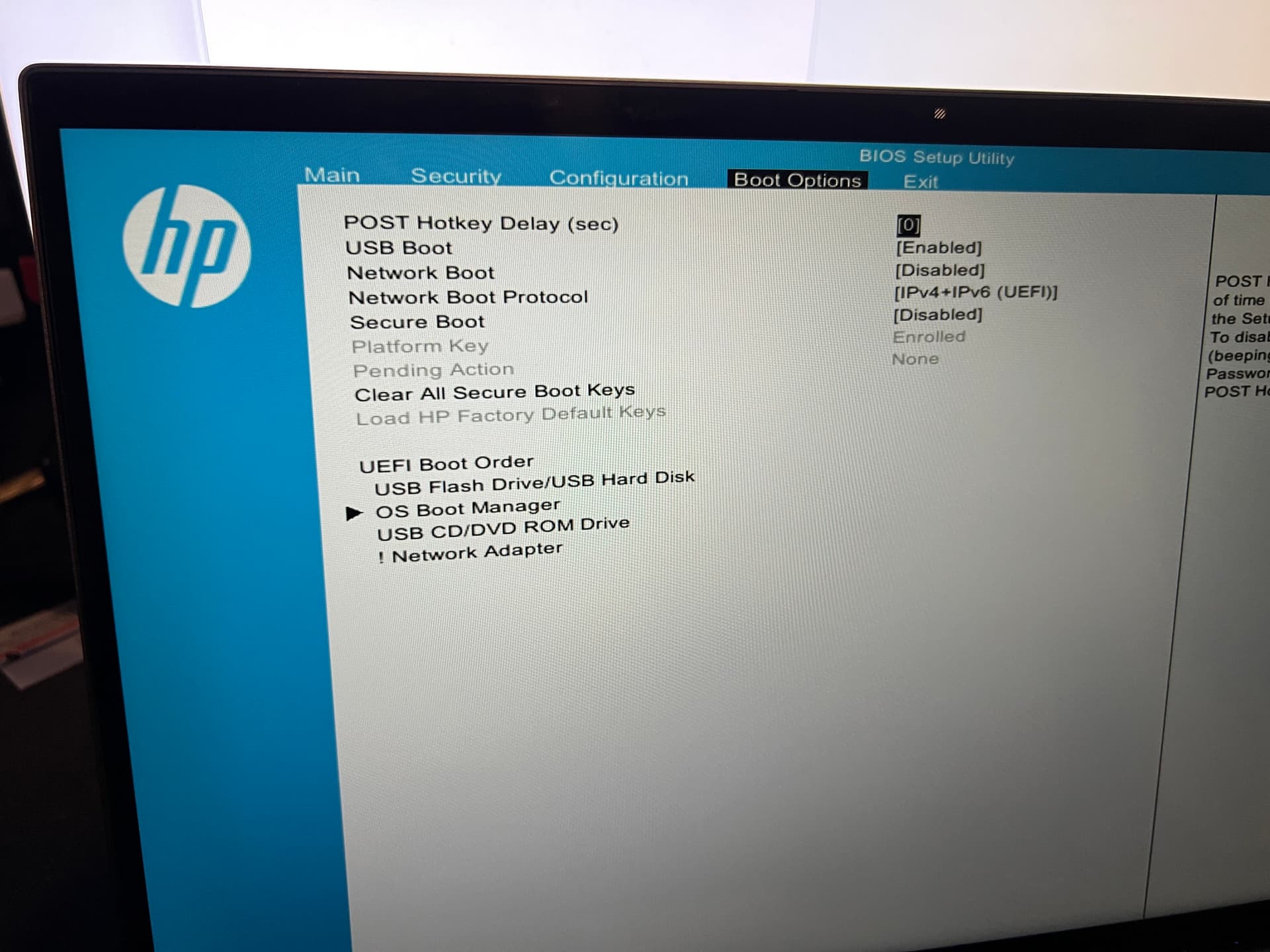

Secure boot is still disabled, along with usb having priority in boot order

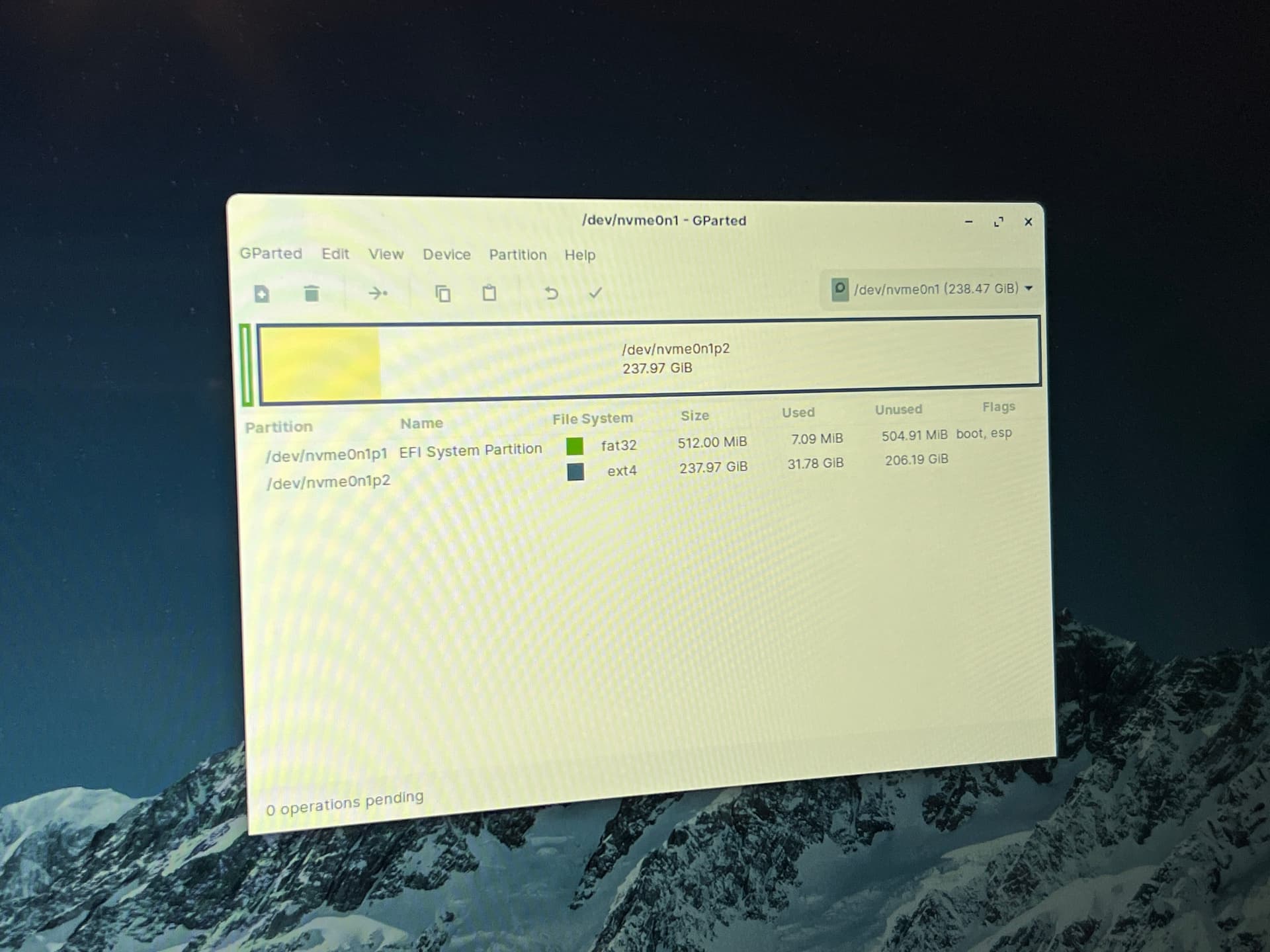

Can you boot LiveUSB Try Zorin, and launch Gparted and take a screenshot and post the partitions shown here?
EFI 512 boot partition.

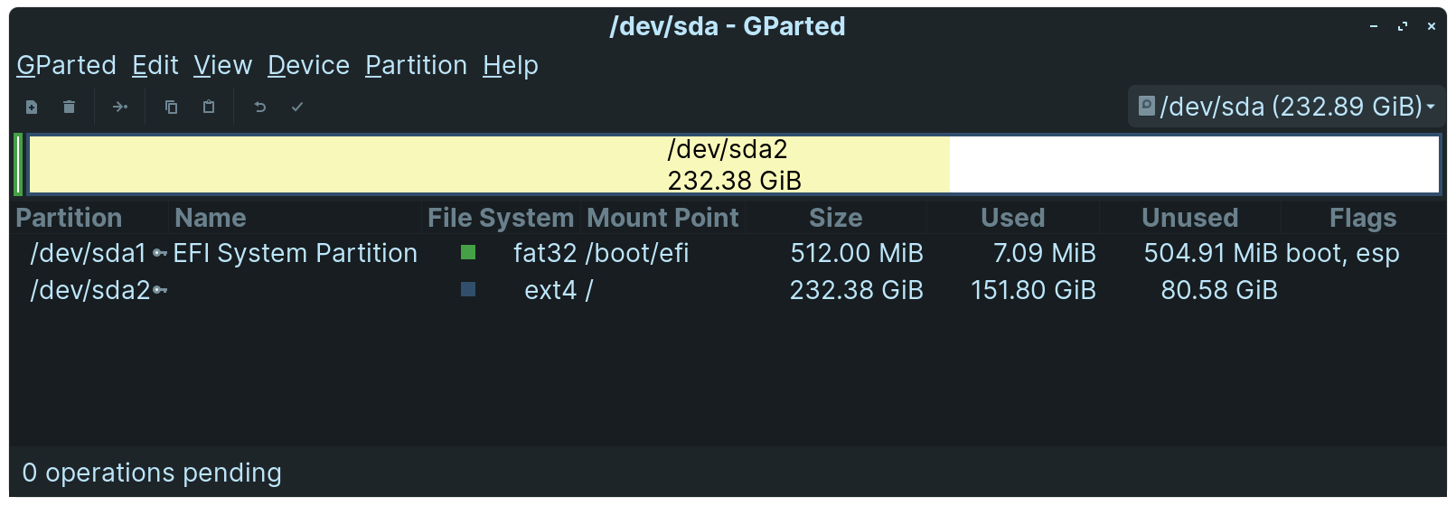

I see in your "Gparted" photo, it doesn't show the column "Mount Point", The only way i could replicate this was to try Gparted while in Zorin OS "TRY" mode ( booting from usb installer into try mode shows no "Mount Point".) as per photo.
Making me think you still have the usb/Bios still at the installer.
where as on this machine & others i have all show the Mounting Point column.
