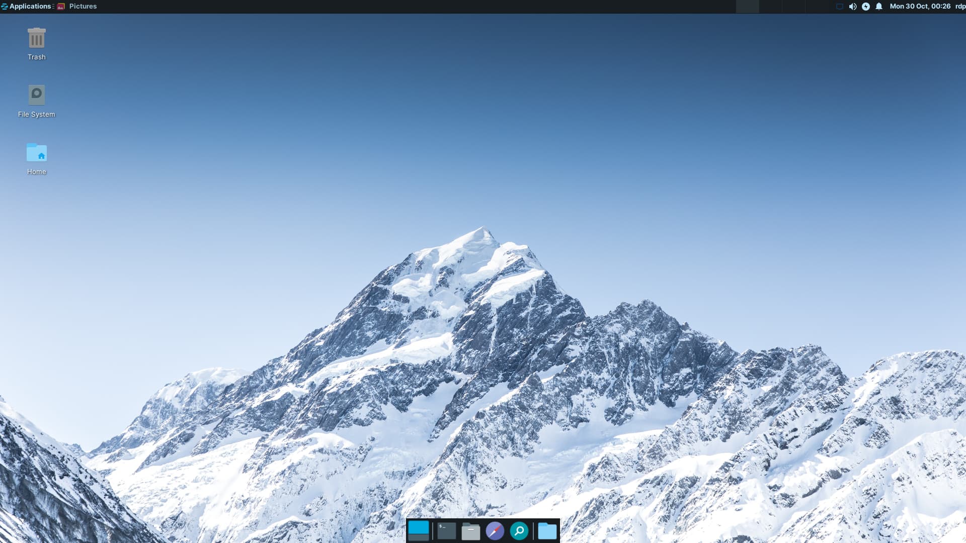

Looks like that worked. I basically selected a single image as background, closed the RDP session, and reopened it and the wallpaper was still there. This is what it looks like now:
It looks like what the next step is is to setup your desktop emulating what the default Zorin OS desktop does in order to create these configurations in your User ~/.config directory.
