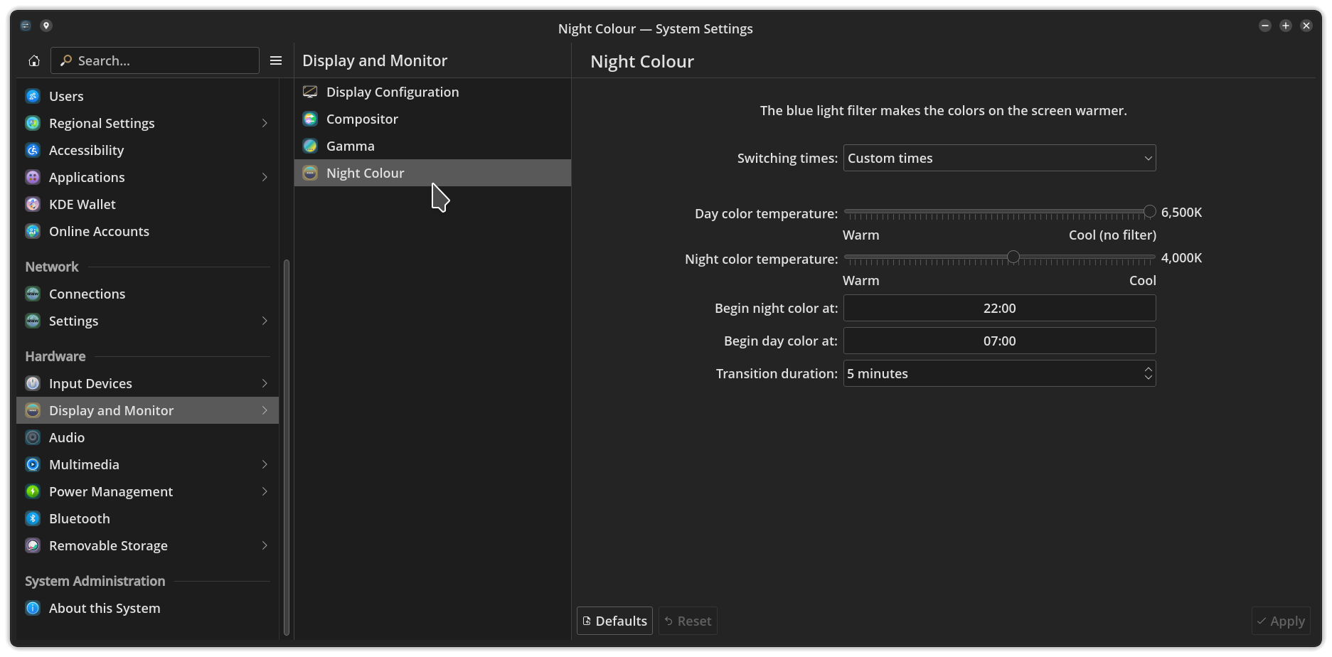

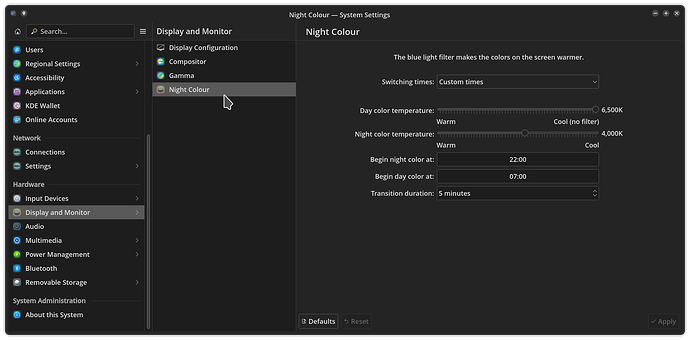

Automatic dark mode for Plasma:
Note that this means you have to have 'night colour' settings enabled:

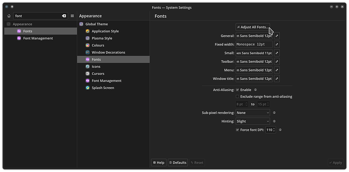

No manner of changing font sizes? Oh so not true - I had to setup my eldest's notebook with Plasma to be consistently 14/16 point Comic Sans:
