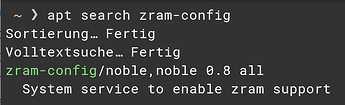

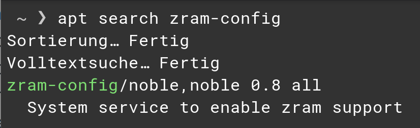

I've read that Zorin OS includes a legacy package named zram-config, which runs an older shell script at boot time, which stops my zram- generator config settings from being used.
Not sure what will be best:
Uninstall zram-generator and leave the older shell script to do its thing, or remove the conflicting Zorin package?
That is not installed by default:
