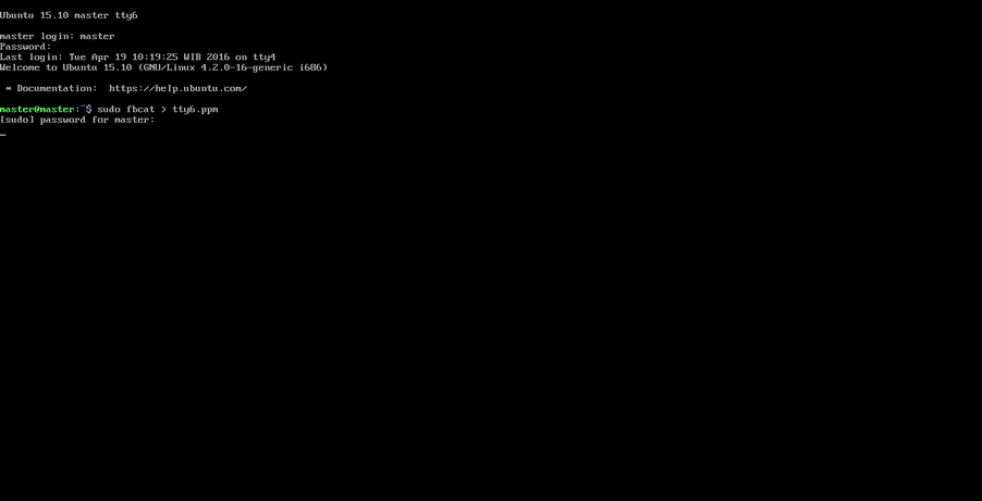

By this, do you mean it is logging into the tty?
I don't know what you mean by TTY? But what i can say when i log in for the first time and then restart Zorin OS i get the Minimal GRUB menu.
Similarly, I do not understand what you mean by the Minimal GRUB menu.
Here is an image of tty screen in Ubuntu:
I made a picture of the screen;
I have never encountered that screen before. I had to look this one up.
