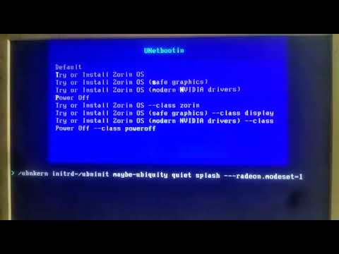

From this screen, are you able to tap the e key in order to enter the grub editor? (Or... what happens if you tap tab?)
We need to try adding the grub parameter radeon.modeset=1 prior to you trying to boot Zorin OS.
thanx i tried
radeon.modeset=1
and radeon.modeset=0 also
both the same result monitor goes off no signal sign
i even tried to write the parameter without the line
but it didn't do anything it returns me to the grub menu
also tried the parameter
radeon.dpm=0
but same result
