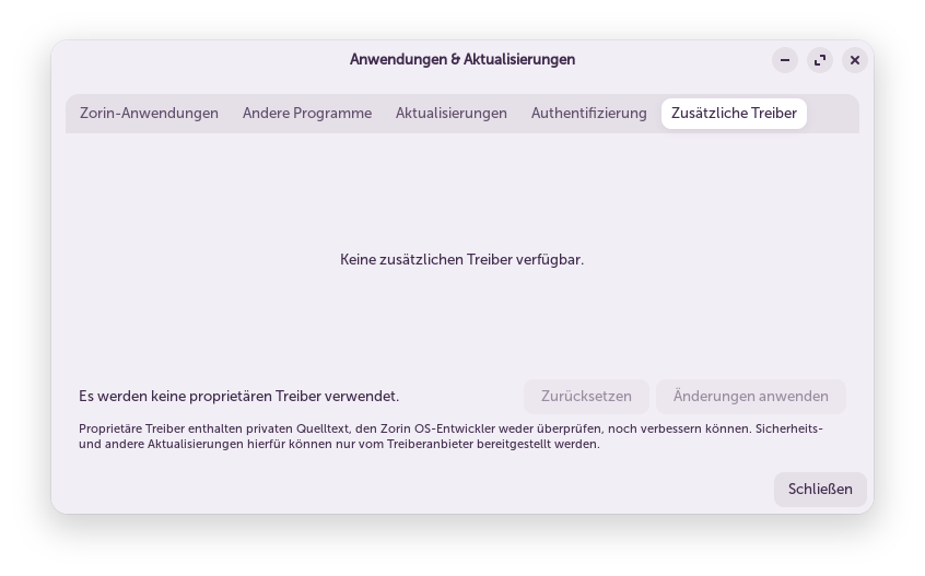

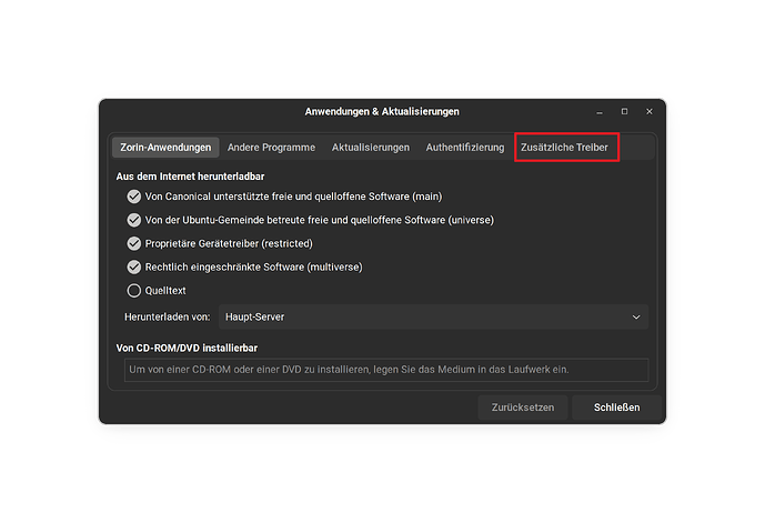

When the Dongle is plugged in, do You see at the ''Additional Drivers'' Tab in Software & Updates any Drivers offered?

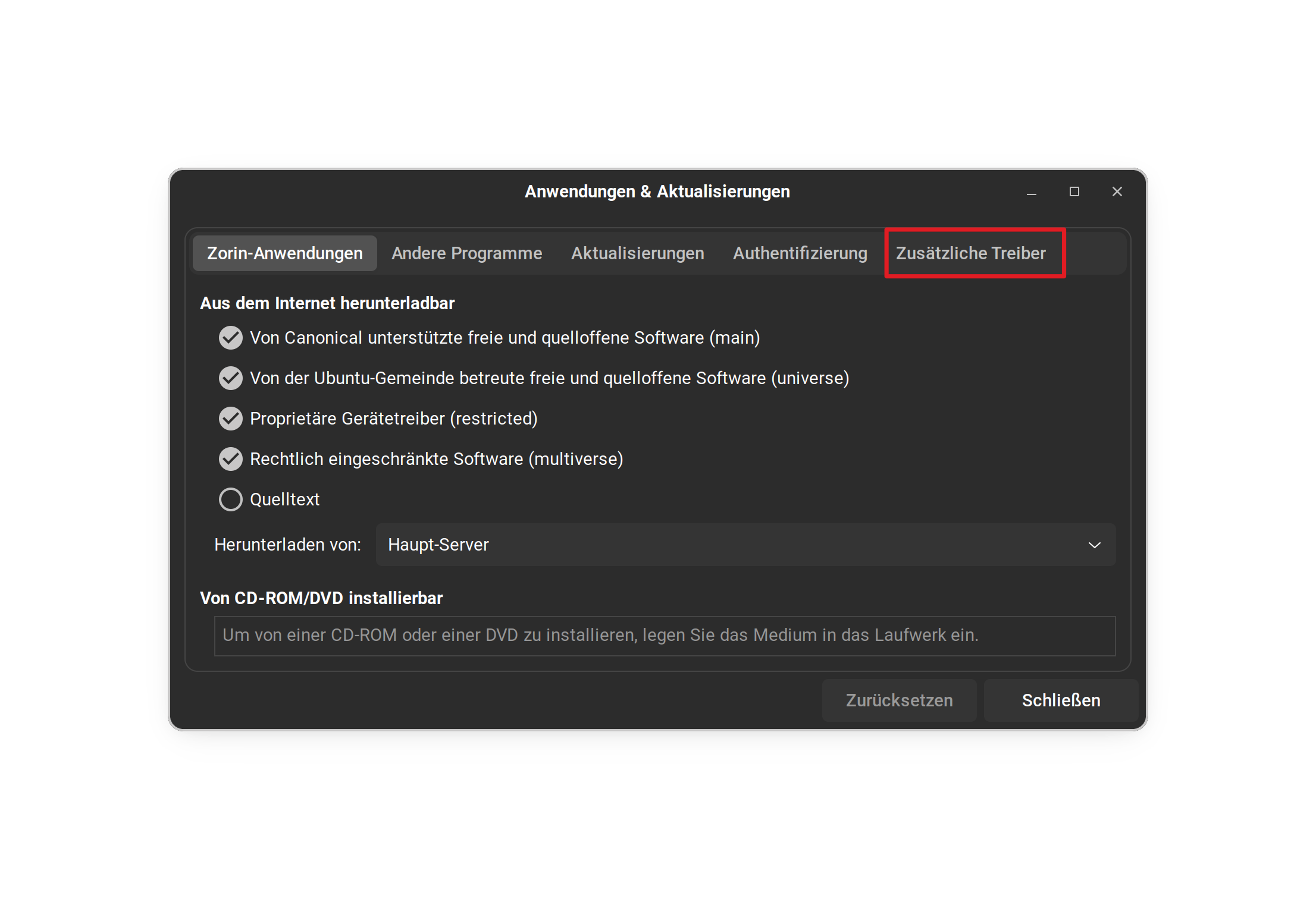

I run Zorin in german. Could you point me to the "Additional Drivers" Tab more precisely, please?

open the software updater...let it run then hit settings then the additional drivers area
You open ''Anwendungen & Aktualisierungen'' and there far right is ''Zusätzliche Treiber'':

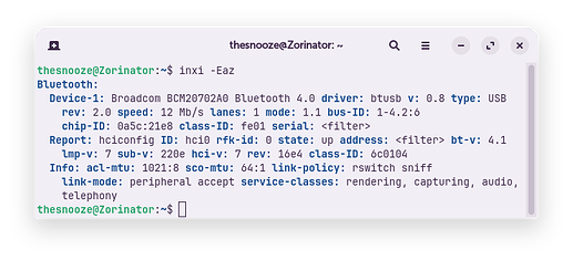

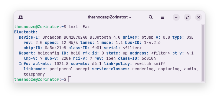

Can you please open a terminal, (just type the word terminal in the search bar of the menu and press Enter) and copy and paste the following command:
inxi -Eaz
And post back the results please.

No additional drivers are shown there. I guess that's a hint? :smiley:

Thanks. That's the info I was looking for! Here's the result:
Thanks for your reply. Here's what the termianl came up with:

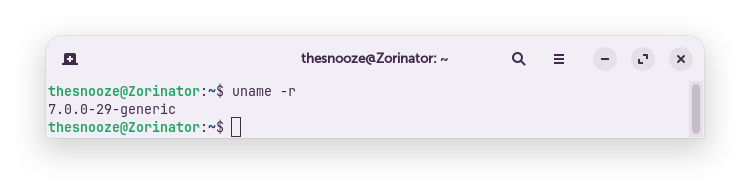

I'd recommend to update your system. The current kernel is 7.0. Kernel 6.14 has reached its end of life.
After the update and a reboot, check with
uname -r
if you are running the new kernel.

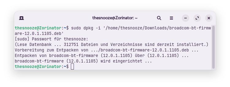

In regards to your bluetooth you need to take a look here:
It is. That means it isn't a seperate Driver this Way provided. Now, it could be supported in a Kernel but if I remember correctly Broadcom Drivers are not in the Kernel.

@Forpli I did change the Update-Server to Main-Server and running it again it told me it is loading the 7.0 Kernel but upon further inquiry, namely running said command line, it tells me I am still on 6.14. Am I overlooking something?

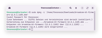

I also installed the provided .deb-Package before and I think that actually led to a successful pairing once.

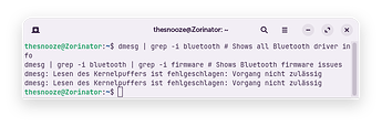

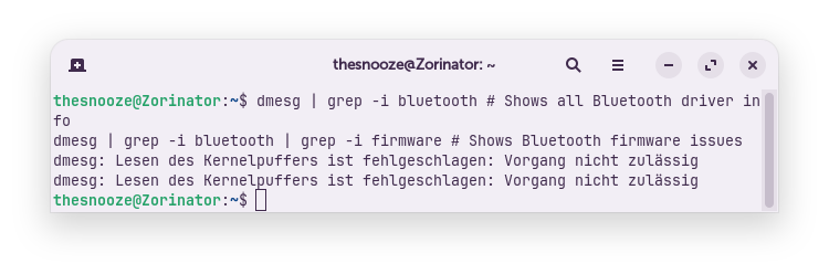

Going into the manual installation I ran the suggested command and got the following result:
Translation: Erron on reading the kernel buffer: Process not allowed

Did you reboot after the (kernel) updates?
Do you have set 6.14 kernel as default to boot from, e.g. by following such a guide once, and is in your file /etc/default/grub
the line
GRUB_DEFAULT=0
replaced with
GRUB_DEFAULT=saved
That might explain it. If that's the case, change the line back to
GRUB_DEFAULT=0,
save the file and run sudo update-grub and reboot.
(or in grub menu select "Advanced options for Zorin" and select kernel 7.0 there to boot from, but then your current kernel is set as default and after the next kernel update you would have to select the later kernel again at Advanced options for Zorin.)

Run the commands for dmesg with sudo at the beginning, e.g.:
sudo dmesg ...

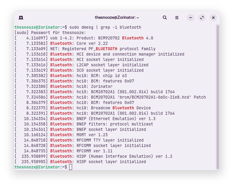

sudo dmesg | grep -i bluetooth
sudo dmesg | grep -i bluetooth | grep -i firmware

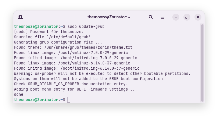

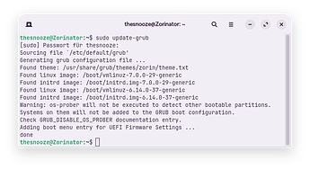

No, I never have touched any grubs whatsoever. I did run a proper update and did a reboot as instructed. Just for funsies I tried sudo update-grub and here's the result it showed:
Seeing these two Kernel-entries got me thinking. I use OpenCore Bootloader and it always displays two Linux drives. Even though I only have one installation. Upon a closer look I could see the Kernel number in their description and I always chose the "wrong one" with the 6.14.-Kernel. Hence the problem. But I got it solved, booted the right one and now I got this:
So, the Kernel-issue is resolved. Can I "delete" the old Kernel somehow? Or is that neccessary?
BT is still not working though. Here's what sudo dmesg | grep -i bluetooth yielded:
As far as I can tell my BCM20702A1-0a5c-21e8.hcd-driver is loading, is it not?
(I tried to look it up manually as instructed in the winterheart-link, but I could not find the path provided in Zorin.) I downloaded my neccessary driver just in case.
