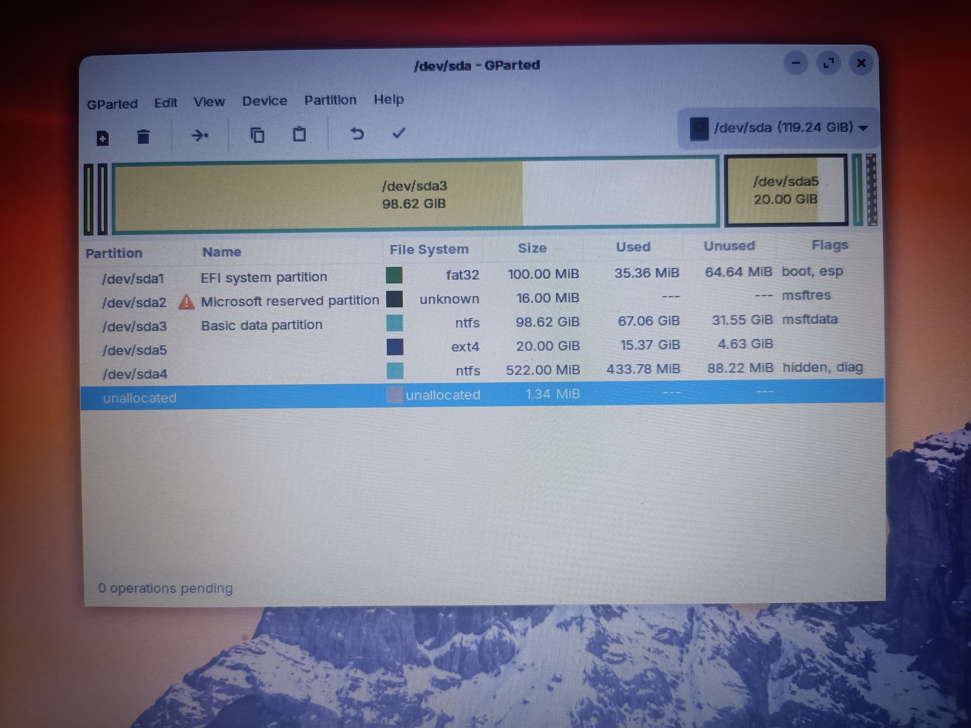

Can you please run "gparted" (search this app in start menu) from Zorin live USB stick and take a screenshot here?
When You are in Zorin, install GParted (a Partition Tool) with sudo apt install gparted and then open it and post a Screenshot of the Partition Table please.
When You are in Your BIOS: Are You abble to set the ''ubuntu'' Entry on first Position?
This is what the Gparted look like:

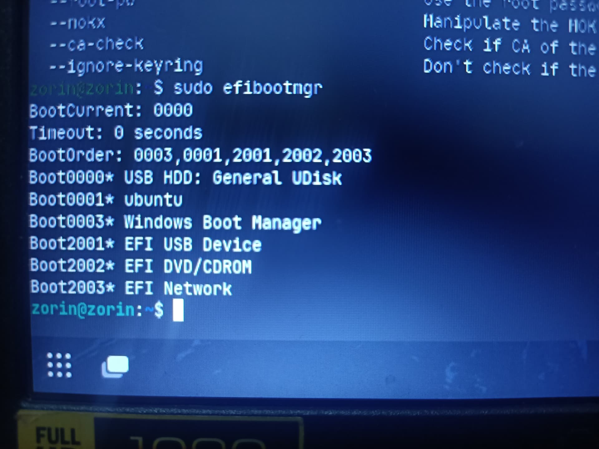

Please share the outputs of the following commands:
sudo mokutil --sb-state
sudo efibootmgr

Windows is set at first boot position instead of ubuntu.
Ubuntu boot entry is there, try to reorder and put it at the beginning of the list.
sudo efibootmgr -o 0001,0003,2001,2002,2003
Run the above command to reorder and then verify the new order again with sudo efibootmgr - If Ubuntu is at the beginning then reboot your device, now it should boot into Zorin.
after running that ubuntu was at the beginning, but then i restarted my pc and then it booted windows, did i did something wrong?

EDIT: Observation looking at Gparted screenshot in post #9.
EFI partition looks small at 100M.
Also EXT4 partition for ZorinOS at 20GB is also small.
