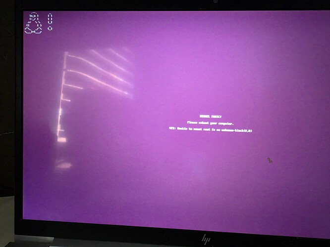

Can't boot after yesterday's update
Try to select Advanced options for Zorin in grub menu and then select an older kernel to boot from.
If the grub menu isn't displayed at boot, press continuosly esc key (or left shift key if you have a legacy BIOS) after start to show the grub menu.
ok , got it to boot in older kernel , then i tried this :
sudo apt update && sudo apt upgrade linux-image-generic

What do i do now before i reboot ? don't want to have to select a kernel every time i boot.

The kernel panics with kernel 7.0 seem often to be related to virtualbox.

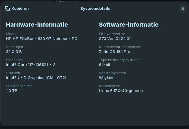

unfornunetly , it did not resolve my problem , still had to select the previous kernel 6.17
how do i remove the bad kernel and leave no trace of it ?

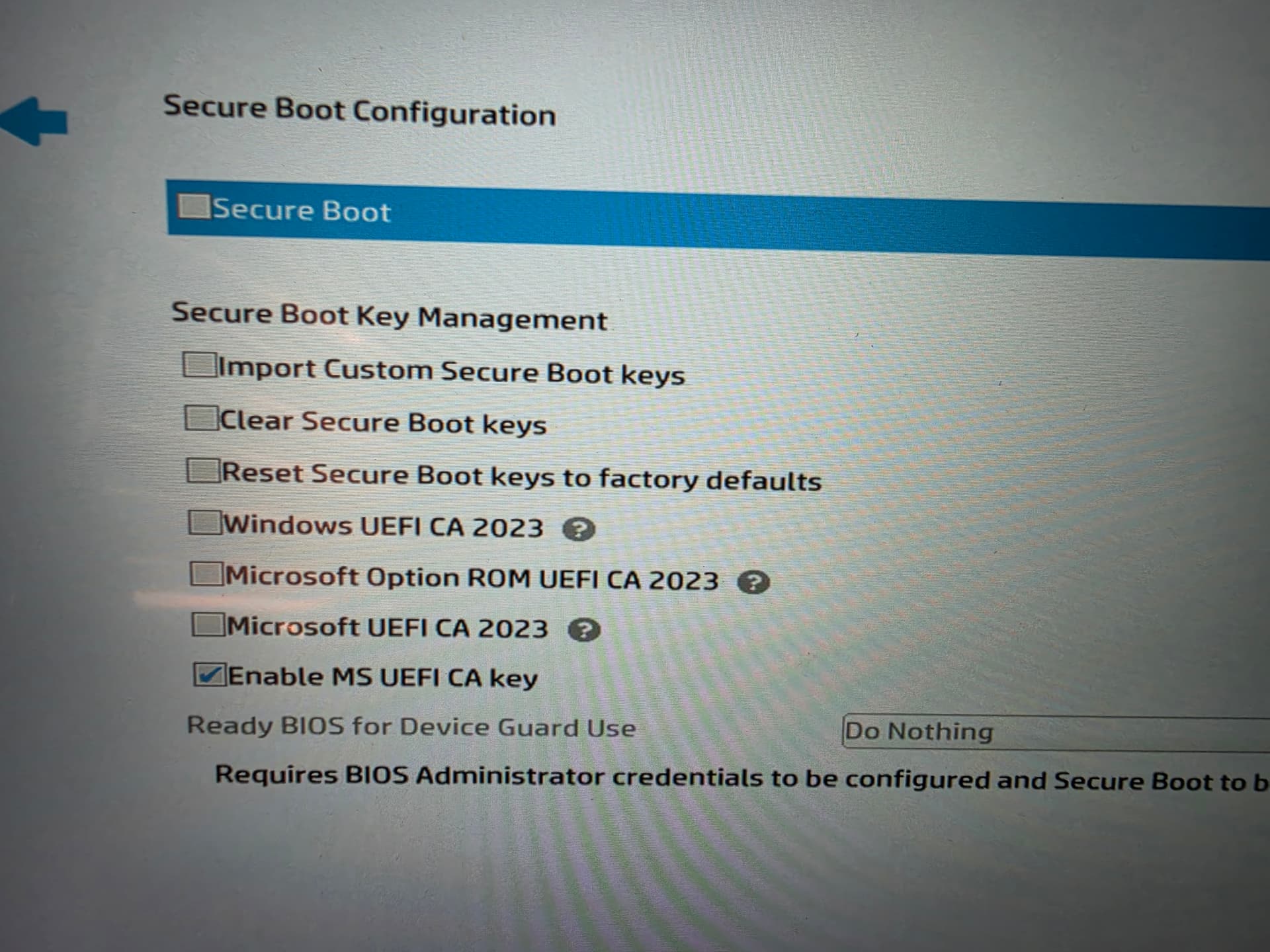

Interesting. Above, it gives a bad return only for VirtualBox:

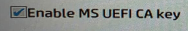

The only other thing I can see is Secure Boot is blocking it.
Its not turned on
Ah. I assumed it could be because of:
Well, why not stick to the working kernel, then?
I suspect that the 7+ kernel does not offer new features you have been dying for.
