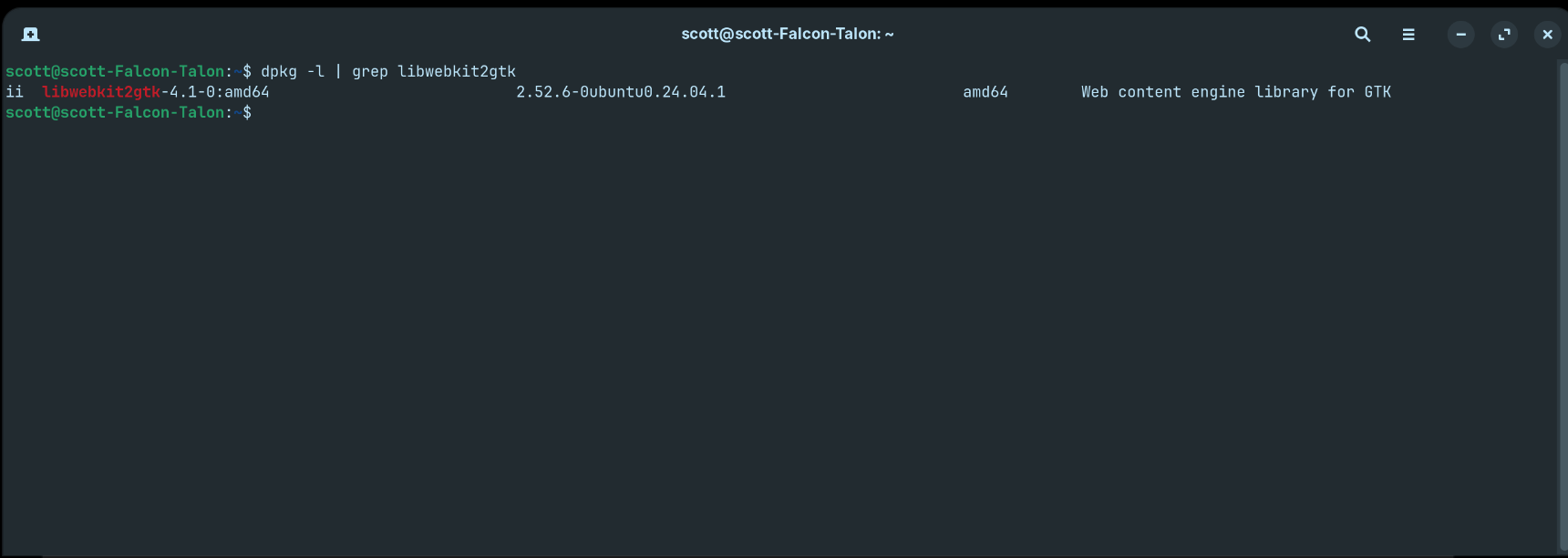

The User @swarfendor437 gave the Info about a current Version Issue from WebKit. That can lead to the Problem that Programs don't start at all.
Please check the Link for Solution Options and give Feedback if it has worked for You.

That said, I could not start OpenRGB a few days ago and solved it by clearing the Fontconfig Cache.
Also, Evolution starts up fine with no problems but I fired it up after I cleared the fontconfig cache.
See below:
FYI - Further info:
