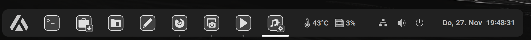

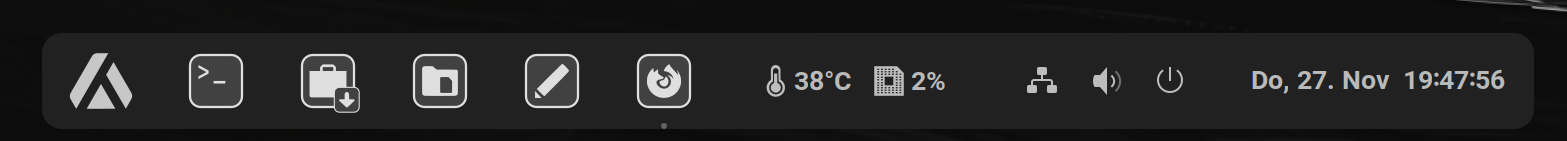

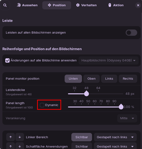

In the Taskbar Settings, You can on the Position Tab where You can set up the Length activate a Mrak for ''dynamic''. then the Taskbar shrinks and expand like needed. Here an Example:
In the 2nd Picture, You see more Icons of open Program and the Taskbar gets longer.

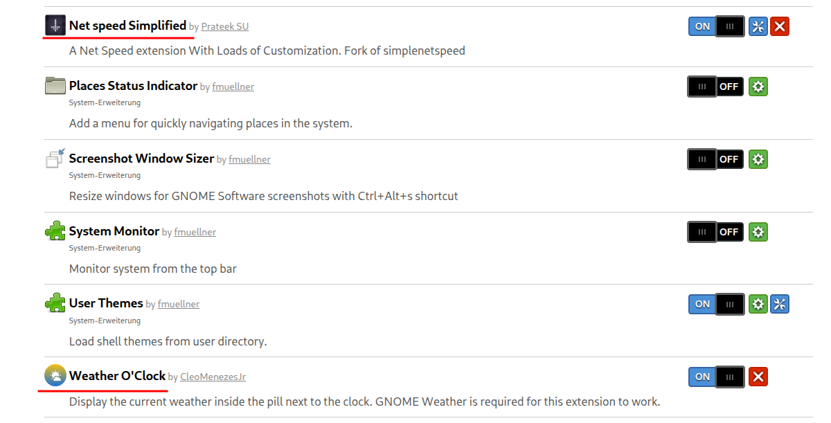

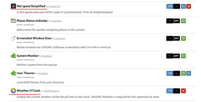

I have only two other additional GNOME Extensions:
Net speed Simplified - GNOME Shell Extensions
Weather O'Clock - GNOME Shell Extensions -
In general I didn't change the default Appearance/Design:
I only enabled this dynamics taskbar/dock feature:

You could disable the both third party gnome extensions for testing.
no, because if I would do so, the taskbar/dock would instantly change back to the defaul position ![]()
that's an idea, I will give it a try
deactivating the weather o clock extension seems to help, but even then the desktop keeps crashing sometimes "randomly"; I'll stop using the dynamic feature, because it's annoying when the desktop keeps crashing that you get this "sad-smiley-face" error picture and your only possible solution is logging out- which kills the whole session. maybe it's the net speed extension, I don't know. But I wouldn't want to miss the extension so I'll live with a general taskbar. thanks anyway for your suggestions
