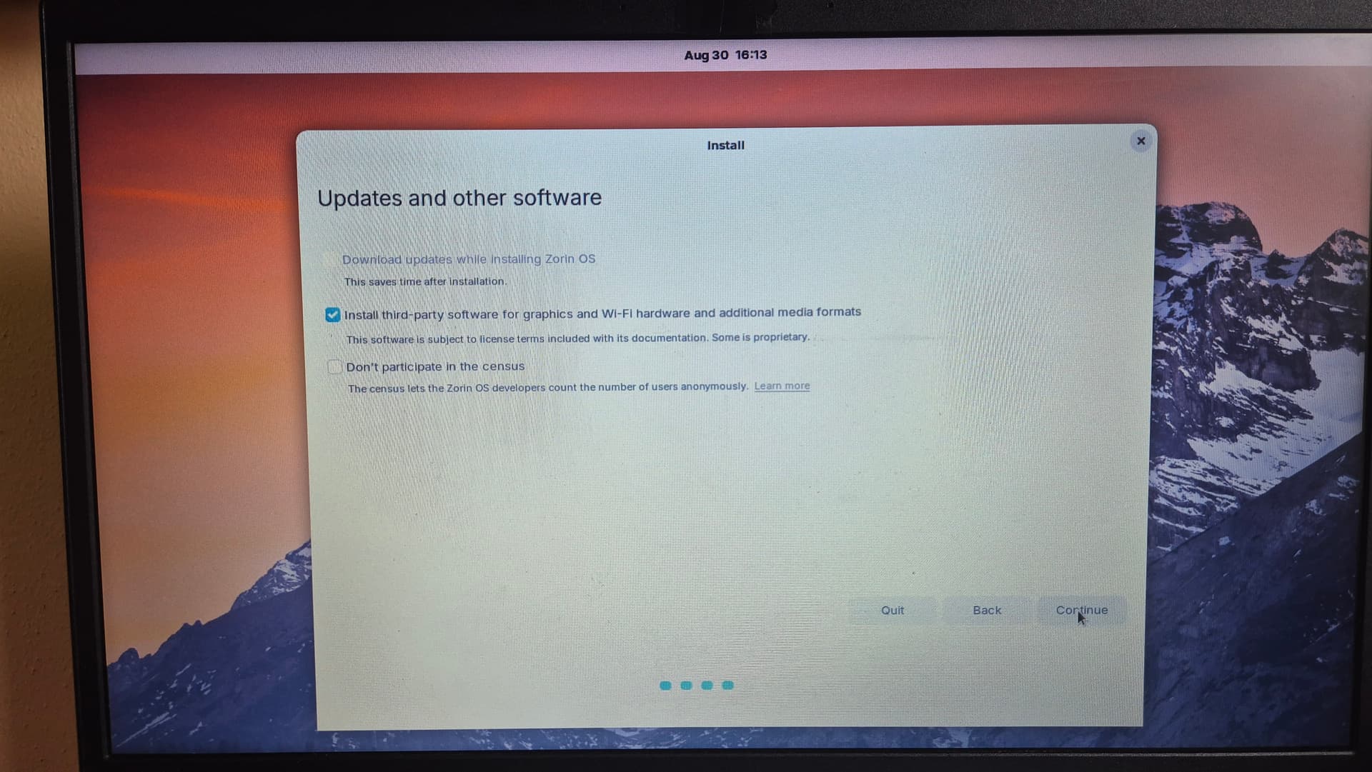

Hi, I'm still having the same problem. During the installation of Zorin OS on my Lenovo IdeaPad s145-15AST, the program skips the "Installation type" page, going directly from "Update and other software" to the final page."
Your drive isn't recognized at all.

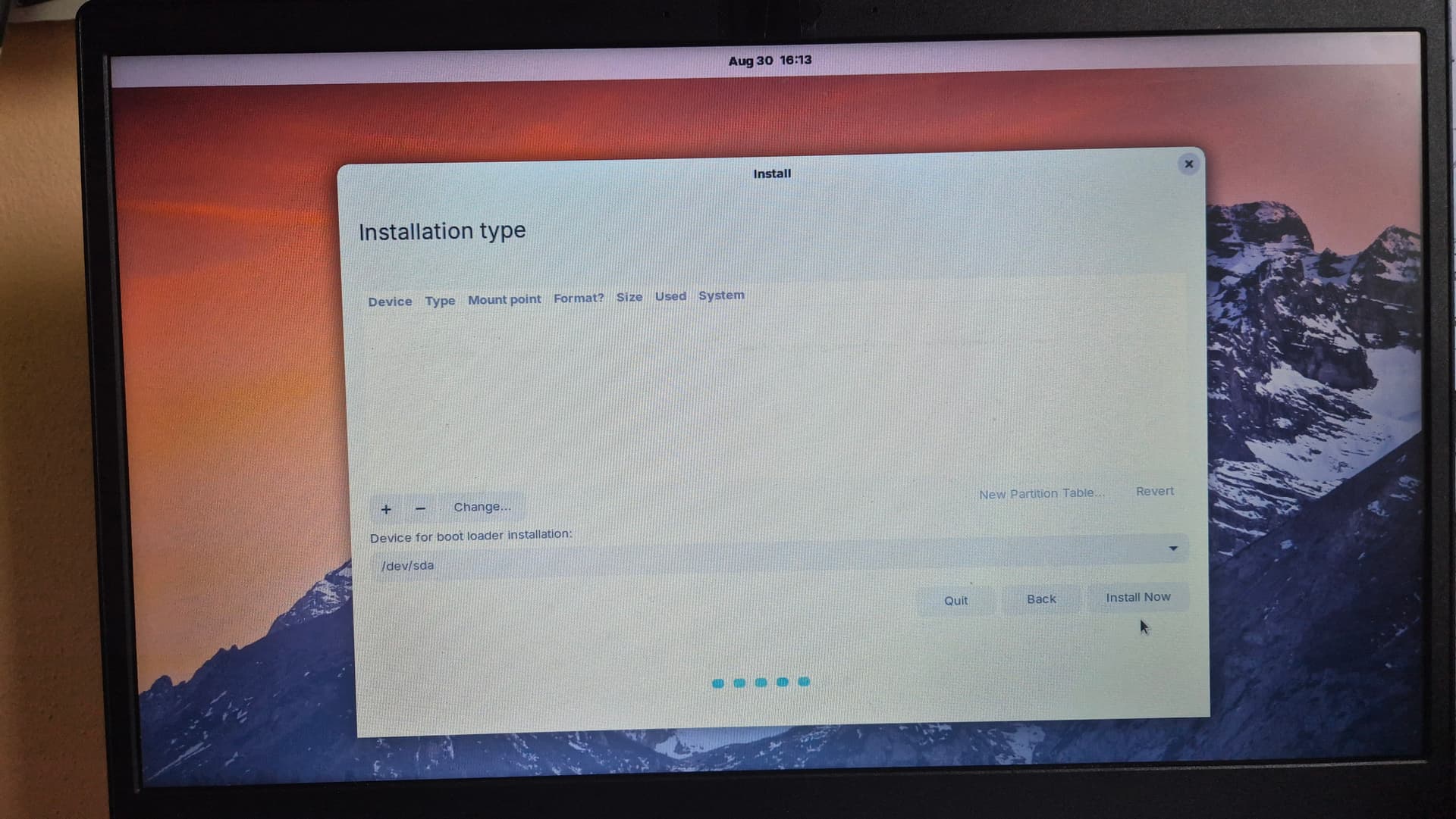

Hmm ... it seems that Your Drive isn't detected - at least not in the Way it should. On Your 2nd Picture is on the Boot Loader Option a Device chosen. so, for me it looks like, it detects ''something''.
How is Your Drive formatted? Another Thing: the Option 'Install third-party software ...'' is checked. When You uncheck it, does it change?

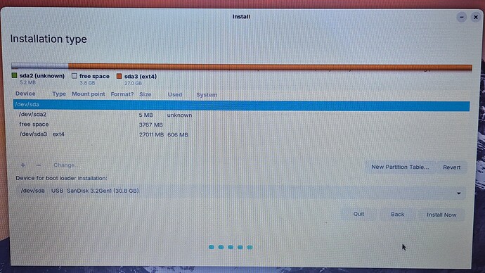

So, I created the bootstick with BalenaEtcher. I disabled Secure Boot and set the BIOS to UEFI, but in the BIOS, neither the Fast Boot option nor the SATA settings are available

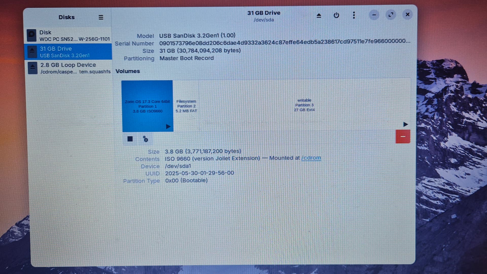

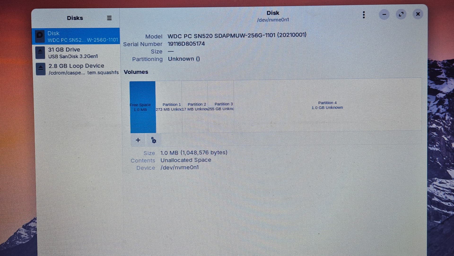

What do you mean? Anyway I went in "Disks" aplication I this is what I see...
And now the "Installation type" show me this
That is here the Thing. The other 2 seems to be USB Sticks I guess? But this one WDC SN520 should be Your Drive. But You also see that there are shown as unknown.

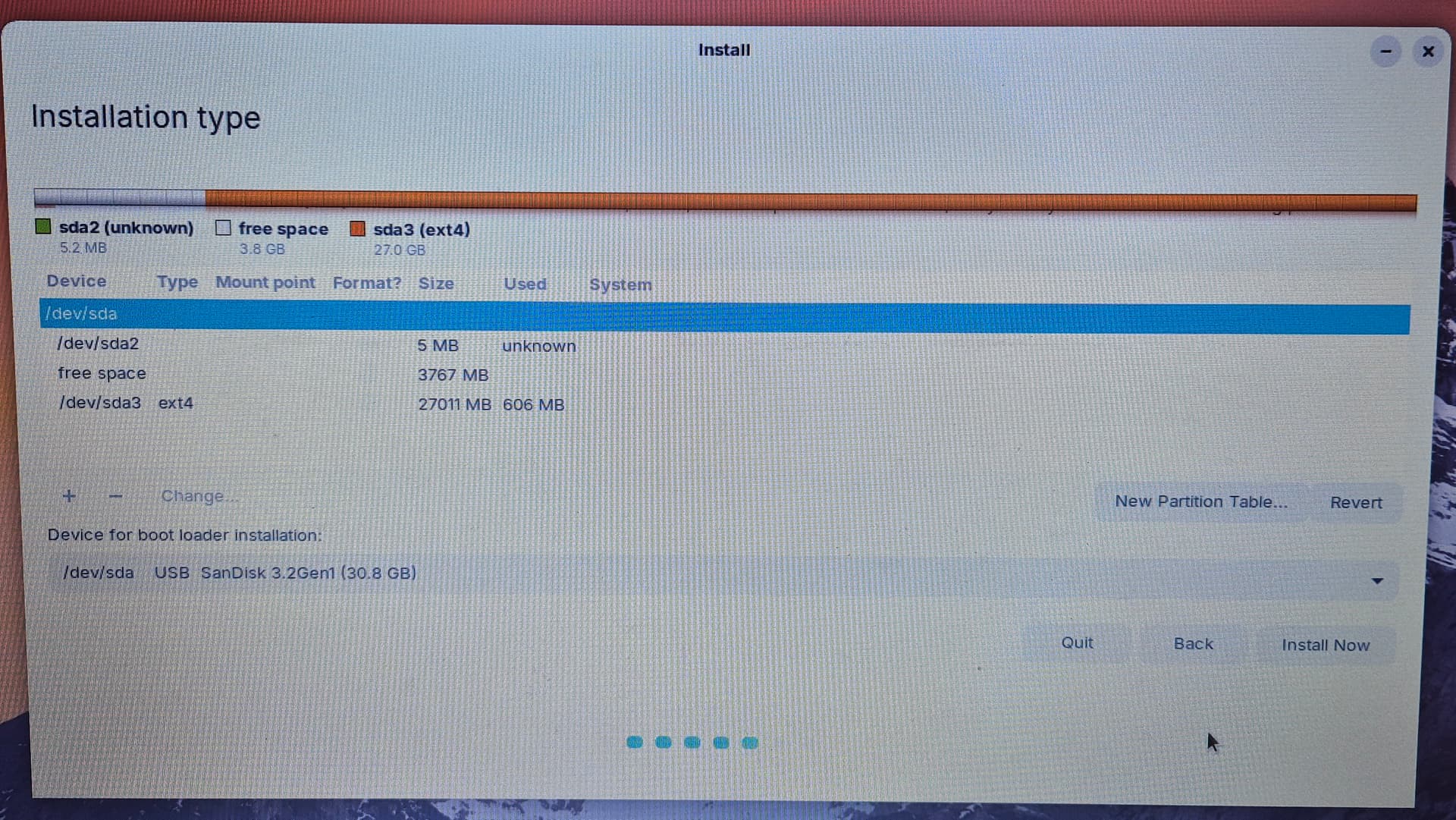

It shows You this because it seems to detect Your SanDisk USB Stick (You can see it on the Boot Loader Option).

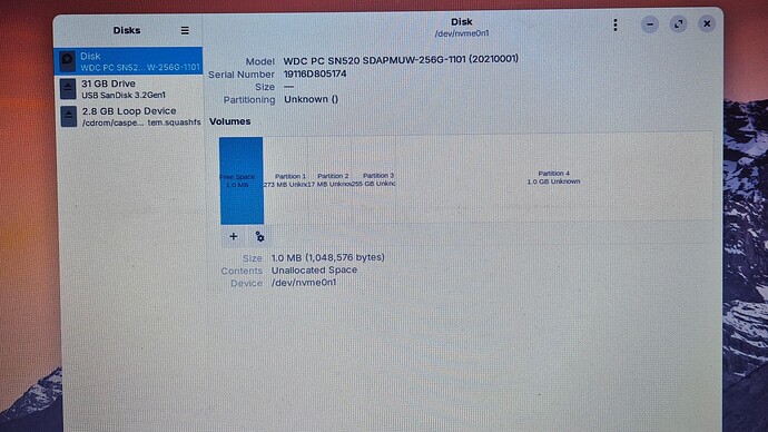

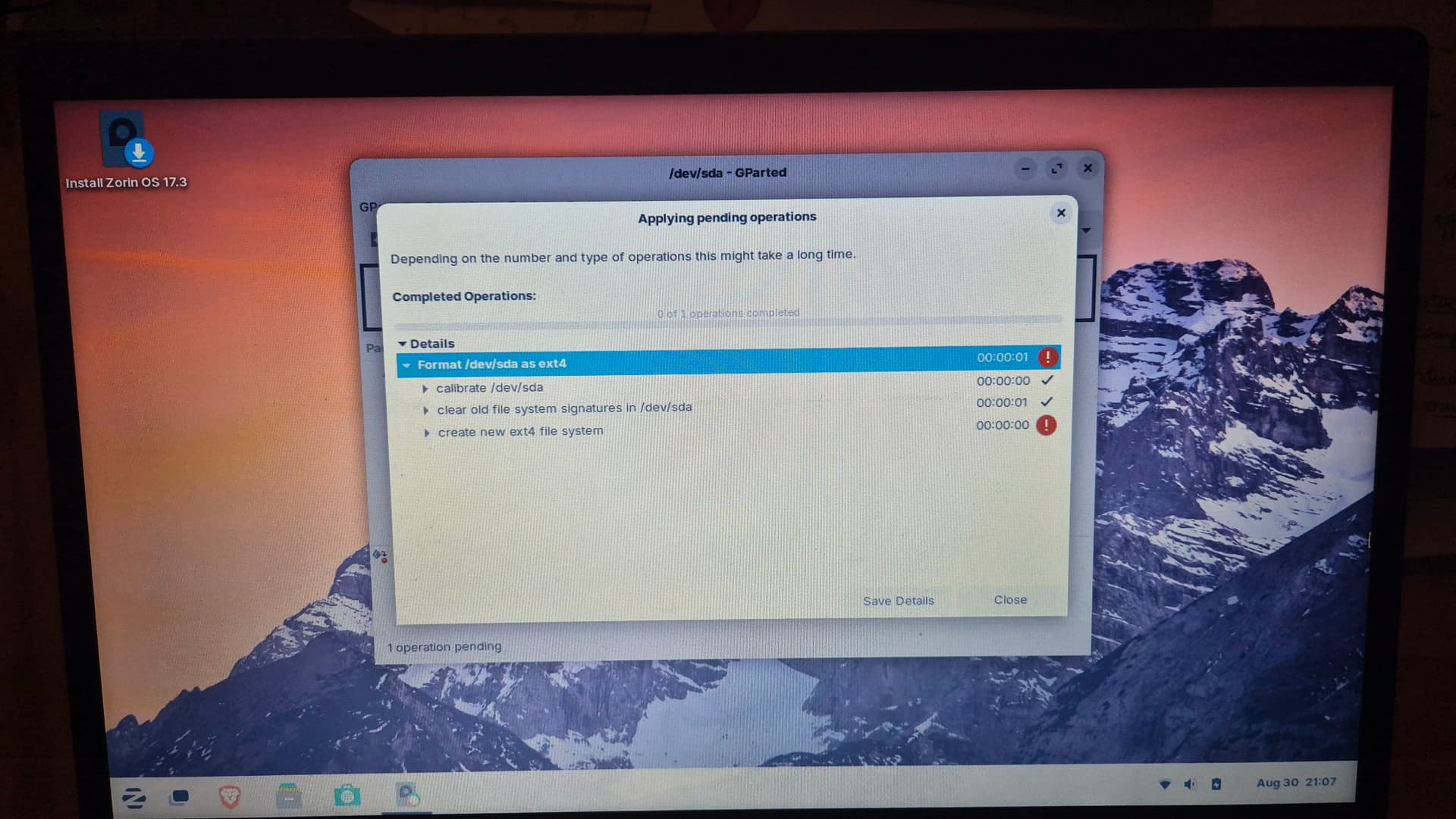

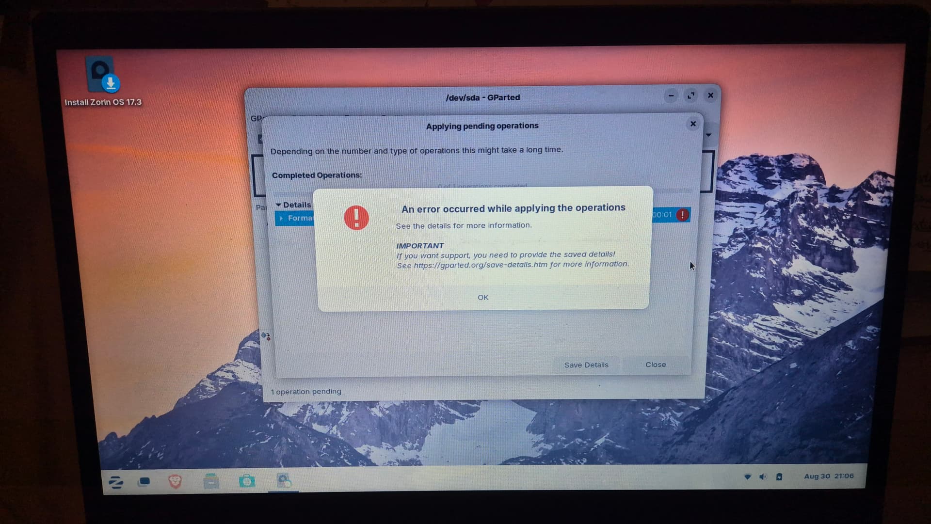

Hi, I have only the .iso in the drive and this is the Live mode. I did as you said and here what I see.

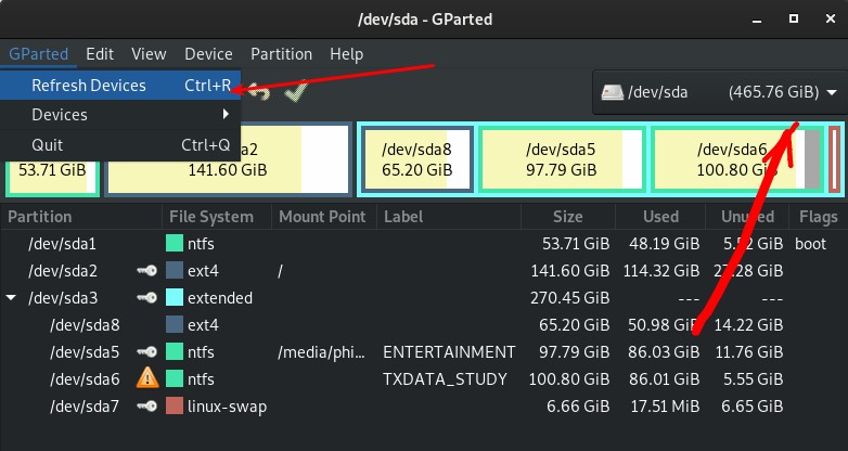

When you run gparted from the Zorin live USB stick (choose the "Try Zorin" mode before) select the drive you want Zorin to install on, not the usb sticks.
Click in the headerbar on gparted>refresh devices, then select the nvme in the upper right corner. Note: Click not on /dev/sda as on the picture but on /dev/nvme0n1
To me it seems as you have selected the usb stick because it shows dev/sda and your drive is a nvme and should be named dev/nvme0n1.
Then delete all partitions (only if you want to delete all datas on the drive!!!).
When you move the windows so that both windows are visible we can see better what the partition size is and if it is the right drive (you can take a screenshot here again)
@Alessa you may need to first confirm this. Boot to Windows and launch diskmgmt, check if the partitions are labelled with Bitlocker encryption. If yes, then you need to disable them first and then try installing Zorin.
If the above still doesn't help Zorin detecting your nvme drive then you may check for any errors in that drive. The following articles have the instructions how to diagnose, check them both.
