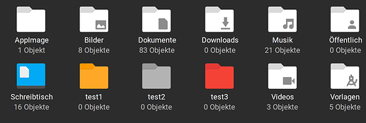

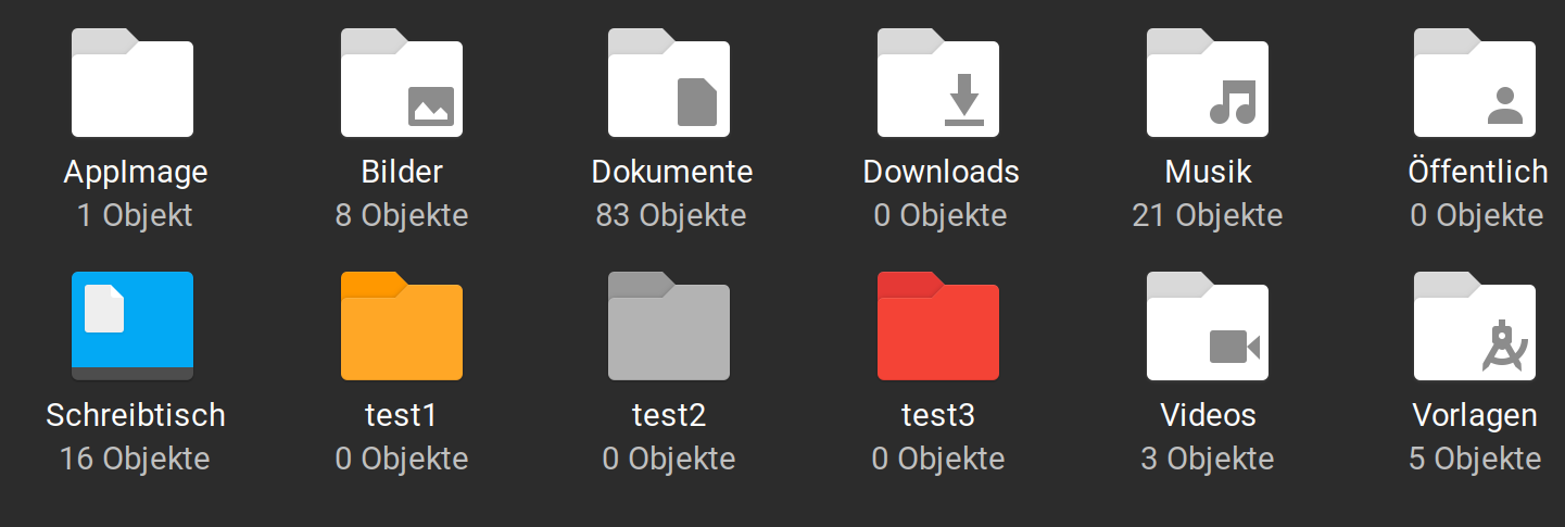

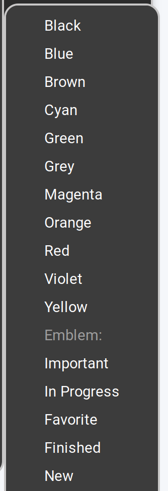

The Color Names are not translated but besides that You can choose all available Colors from the Icon Set when it offers different Colors.
Thank you for clarification!
I found out: In my user's home directory it works and the color of folders can be changed to all colors, but the function can't be used in root, even not with root rights. And I had tested it only with folders in root. Because of this experience I thought it is useless.
The colors themselves are shown in German, just the entry "Folder's color" in English.

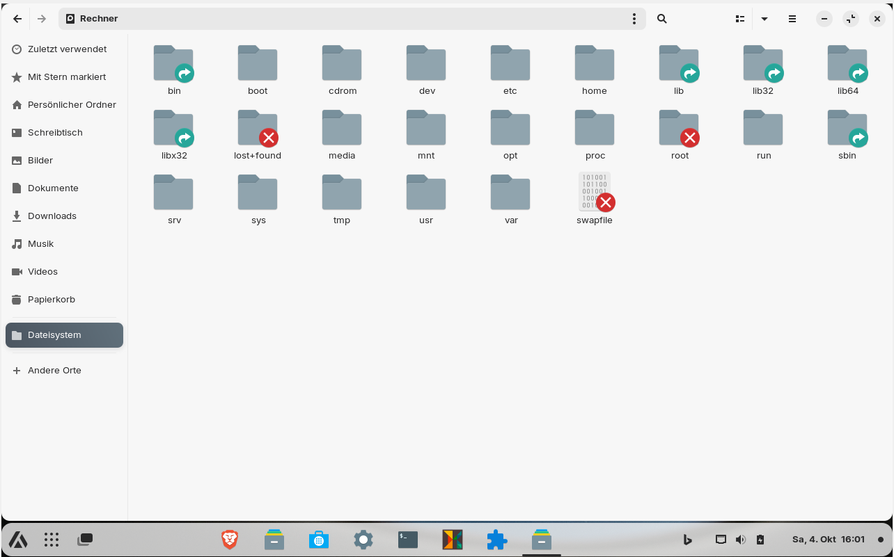

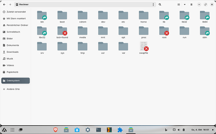

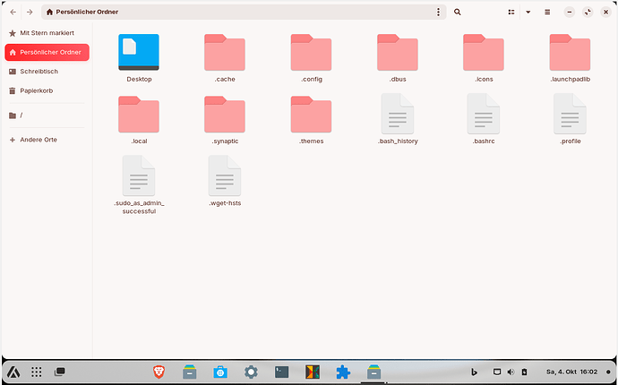

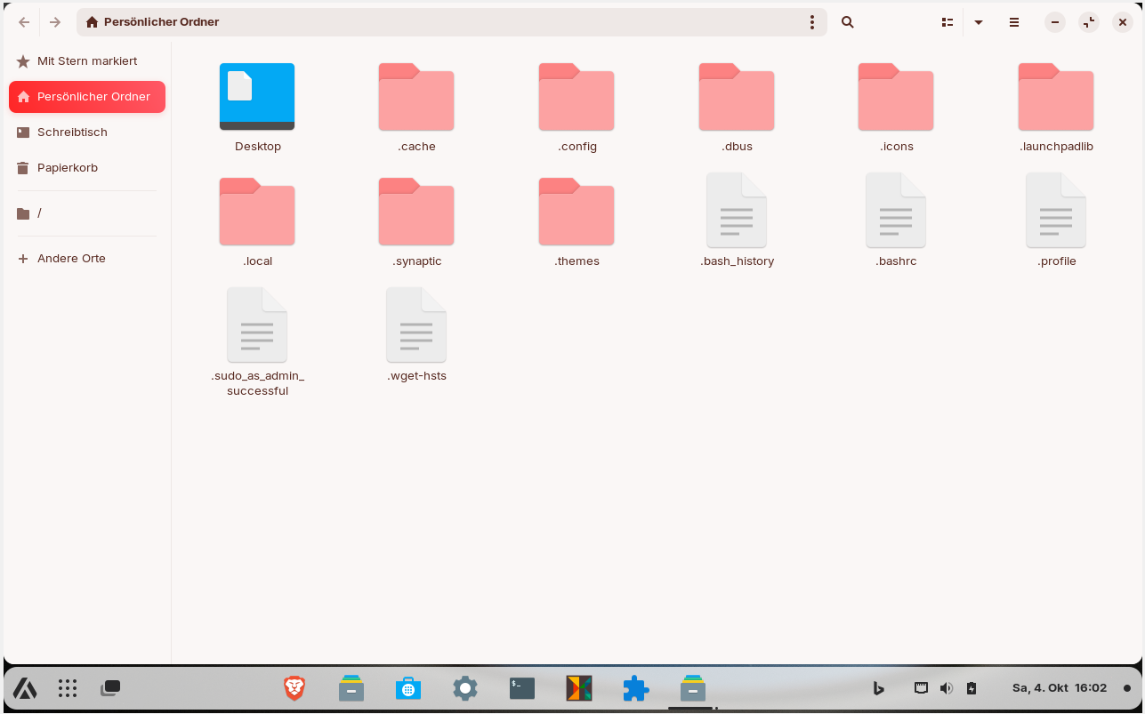

I found a way to get a different theme when nautilus is opened as root. Unfortunately, this affects all programs that require root rights, as e.g. synaptic, gparted, software updater..., but doesn´t matter. I think I´ll change it to another color or another theme - I just wanted to test if it works at the moment.
opened as user:
opened as root:
Because editing the css file was too difficult for me (there are so many lines with headerbar, sidebar, infobar...), I used this trick:
I created two folders in /root: /root/.themes and /root/.icons. Then I copied ZorinRed Light gtk theme and ZorinRed Light icon theme and pasted them into these folders. Then I renamed both to ZorinGrey Light which is the theme of my normal user.
Now I can see at a glance when something is opened with root rights, especially nautilus.
